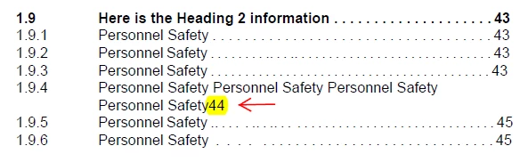

I have a Table of Content, in which I have some entries that expands to two lines.
When Table of content entries expand to two lines, Leader Line are not added and page Numbers shows next to the entry.
See Image below: Entry with RED ARROW -  1.9.4 shows Page 44 without Leader Line:
Any explanation will be appreciated.
Thank you.

    Oct 4, 2016 10:19 AM UTC
    Lynne's answer is right regarding the Since there is no tab on the last line, there are no leader dots and the page number is not right justified.
    As an alternative to what Lynne wrote, you might want to add simply a second tab in the reference page, so that the page number get's pushed to the right also for line 2.

    Aixtron,
       I am surprised by your example. I have seen similar problems, but only when the page number is the only text on the last line of the entry. That situation can occur when the page number is preceded by a right tab with leader dots. If there is no room for the page number following the text, the penultimate line ends with the tab and the page number moves to the next line. Since there is no tab on the last line, there are no leader dots and the page number is not right justified. However, if you define the entries to have a space before the tab, then FrameMaker will break the line between the space and the tab. The last line therefore starts with a tab so there are leader dots and the number is right justified.

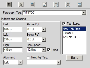

    Here is the Paragraph Tag TIT2TOC and Tabs are defined. Are you suggesting that in all my Heading 3, I should keep blank space in order for Table of Content to have space before the Page Number?

    Lynne A. PriceCorrect answer
    Oct 3, 2016 9:29 PM UTC
    No need to change the Heading3 paragraphs. Look at the reference page of the table of contents. There is probably a page tagged TOC that defines the format of the entries in the TOC. It has paragraphs whose tags are derived from the paragraphs in the main document that generate entries by appending TOC to the original tag. Thus, entries for Heading3 paragraphs are tagged Heading3TOC. The reference page has a Heading3TOC paragraph that looks something lke:
         <$paranumonly>  <$paratext>.........................<$pagenum>
    where there is a tab character between <$paranumonly> and <$paratext> which moves the left side of the <$paratext> to 2.0cm and another tab between <$paratext> and <$pagenum> which moves the right side of the <$pagenum> to 12.0cm.
    I am suggesting putting a space before the second tab. You might also add an extra tab before the <$pagenum>.
