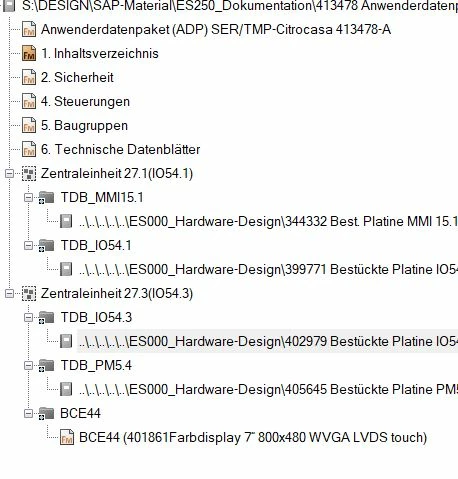

I had created a book file with documents containing other book files.
The general ledger has a table of contents and the books in the general ledger also.
My problem now is, when I save as.pdf, the main table of contents is exported, but the other "slave" table of contents is not.
Are there any settings I need to make?
Thanks for the help
Patrick.

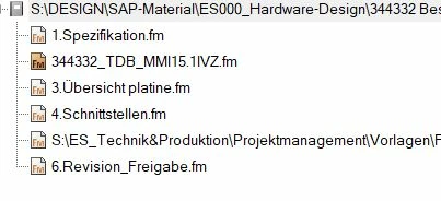

    Hi Patrick:
    Trying to understand the question:
    1. you have a book file (and calling that a ledger) that has a generated TOC for all of the chapters in the book.
    2. you have generated stand-alone TOCs for each of the chapters.
    Is that right?
    1. If not, please share a screen shot of you book window so that we can see the structure.
    2. If right, when you want the stand-alone TOCs to be part of the PDF, they will needed to be added to the book window.
    ~Barb
    Jul 30, 2019 2:57 PM UTC
    Hello Barb,,
    thanks for your help. Here is my screenshot form the structure.
    The book file in the book in this example TDB_MMI15.1
    I should probably say that I've only been working with the program for a short time. so i do not know how to add the TOC to the main book
    thanks for help
    Patrick
    Jul 30, 2019 2:59 PM UTC
    *the TOC form the other bookts to the main book (example TDB_MMI15.1)
