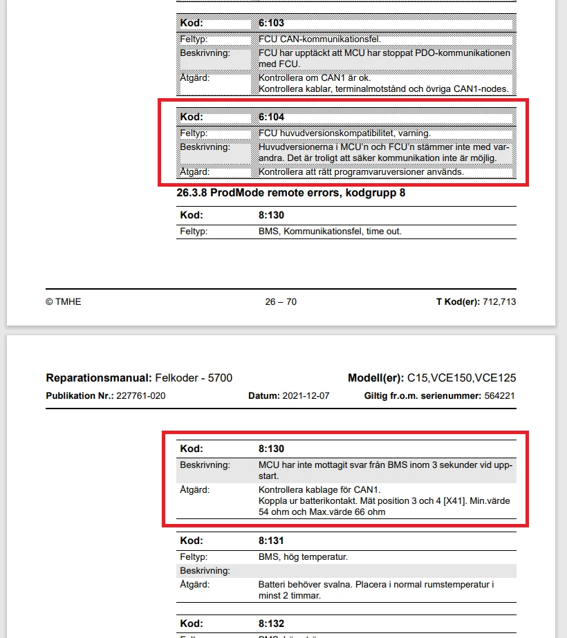

Hi, received an old FrameMaker file, I think from 2019. I inserted a few tables to the document and the tables created 2019 have a grey shade or box around the tables and around all the cells (see the top red box in the attached image). When I zoom in, it looks like small crosses. When I am inserting a table in the file, the table looks fine (see the bottom red box in the attachment). I have compared all the settings and parameters between the two tables and they are the same. Dose anyone have any ideas what is causing the shades?

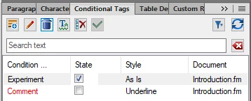

    Most likely there is a condition applied to the table in question. The following is an example of such a conditional table:
    Select the anchor of the table
    Select Insert > Condition Tags to get this dialogue:
    The condition applied to the table in this example is "Experiment".
    With View > Show Condition Indicator set to OFF the xxx will disappear.
    With View > Show/Hide Conditional Text you contol the conditons themselves

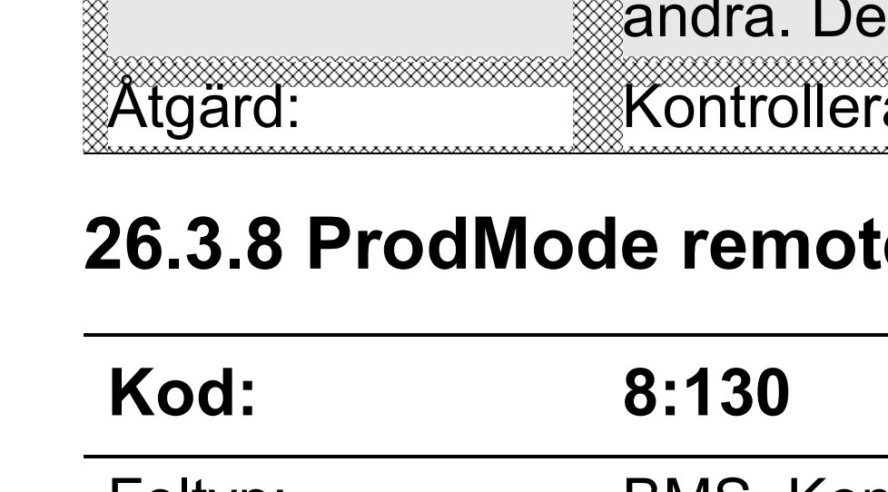

    I am adding a close up of the small crosses.
    How can I get rid of the small crosses?

    Dec 22, 2021 9:17 AM UTC
    Thank you very very much, a simple tick box solved everything. Thank you!
