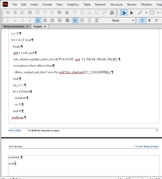

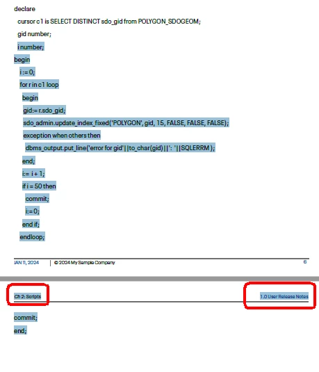

    To describe the issue in details, I am attaching two images:
    1. First Image contains an SQL Script Code which is more than a page. (CodeExceedingMainPage.png)
    2. Second Image contains pdf with code selected. In this we can see that the pdf variables are also copied.
    Required Solution: I want to copy the contents of a code which spans multiple pages.
    Possible solution: Create a Text Table which spans across pages. But how do we do it?

    Hm. When this code spans more than one page, and you select the code on the first and the following pages, you will always select also the footer and the header text.
    If you put the code into a table, and the table continues on a second page, it's the same.
    I could imagine something, where you put the code in a second column with 2 PT and white. Then you could add something like "Copy code here". You would have to test, if your readers would understand.
    You could also ask on the Acrobat forum, if someone would write a script for you, so that you have a button next to the table which copies the invisible code.
