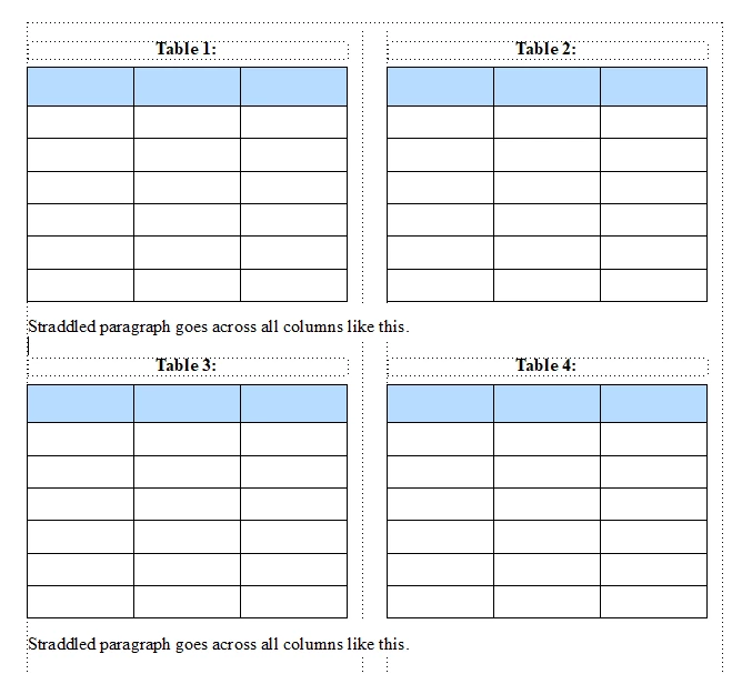

    frameexpert
    Apr 15, 2022 11:32 AM UTC
    You could try using a two column layout with a straddled paragraph after each second table, like this:
    www.frameexpert.com
