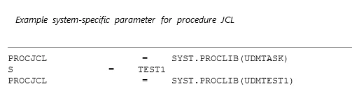

Example:
FM Source:
HTML5 output:
Please let me know if there is some work-around solution if this alignment feature does not yet exist in FM2020. Because there are numerous incidences of this type of code throughout the document, I am not in a position of realignment using tables, etc. I really need a solution on the output end, such as a CSS style.

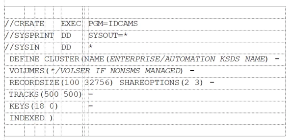

    In the end I created a table with the number of columns equal to the number of tabs you would ordinarily use for your longest line of text.
    Next, using spanning and copying/pasting I was able to align things the way I wanted. Here's a sample.
