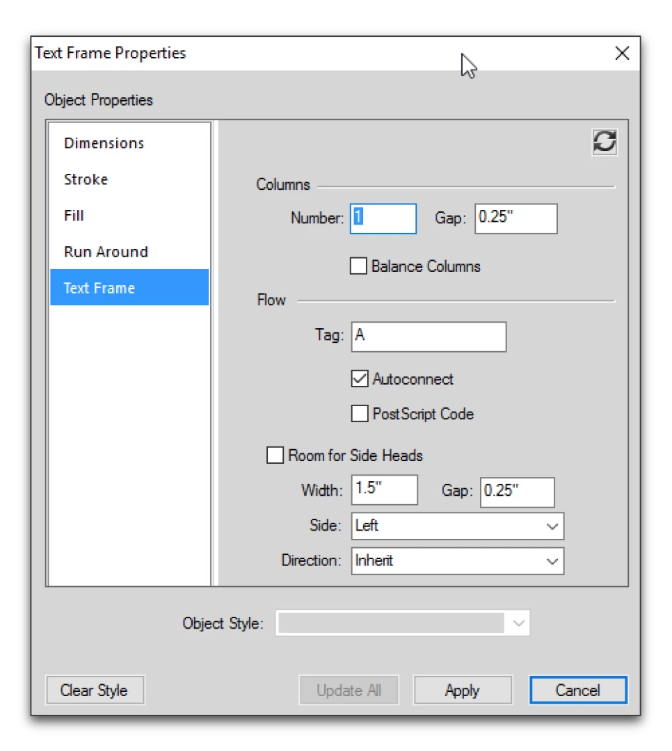

Hi Dana:
That sounds like an issue with the Flow tag and Auto-connect. When Autoconnect is off, the text gets stuck in the frame, and a non-printing black line appears at the bottom indicating the text is overset.
If you had the doc we could help you straighten it out, but it sounds like you are back on track.
June 9, 2016
Thanks so much for your help. I'm back on track for now. If this does happen again, I'll ensure Autoconnect is enabled.
Dana.
