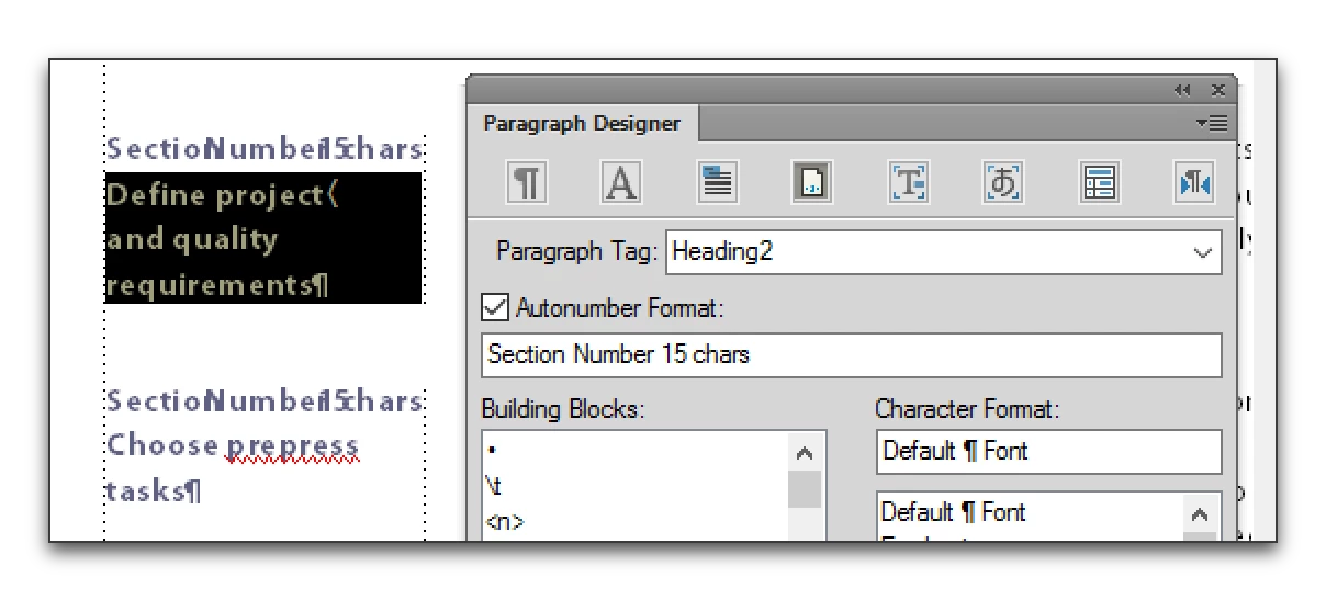

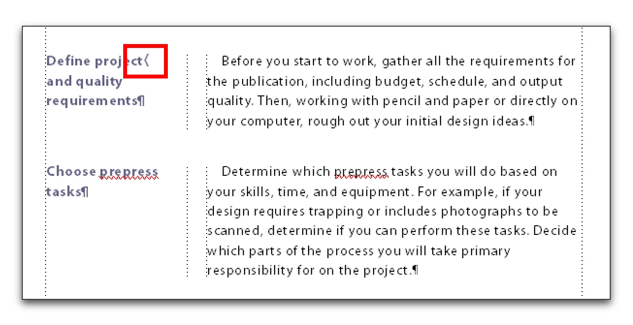

Is there a way to make text wrap or insert a carriage return in a side-head? I have a paragraph format with an autonumber format that is two words, 15 characters total, and a side-head alignment. The text does not wrap, it just overlaps. I'm sure there's a way to make it wrap, but I have not been able to figure it out or to find anything by internet search. Has someone run into this before who can help me fix it?

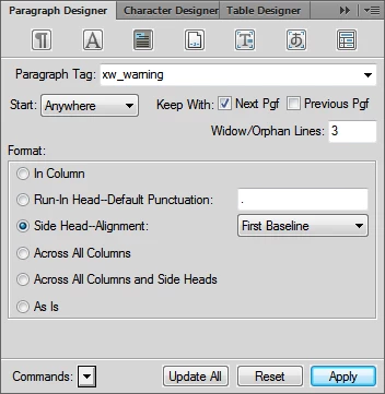

Are you sure the Pagination property for that paragraph is:
(*) Side Head--Alignment
and not:
(*) Across All Columns and Side Heads
Aug 24, 2016 3:38 PM UTC
Yes, I'm certain. Here's the pertinent tab:
