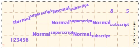

I have a function DrawTextLine which - at it's end - decides whether the text is just placed at the coordinates x0/y0 or it shall be centered within a given length (or right adjusted within this space) - line 20.

In all tests this routine works fine, as the following diagram demonstrates (watch the numbers within the 1cm grid):

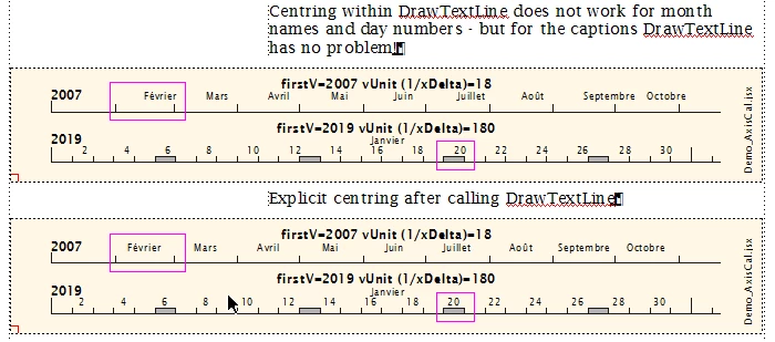

Now, when using this function within in another function DrawAxisCal to center the month name between the adjacent scale tics - it does not behave!
When stepping through the code the text properties show that it should be placed correctly, but it is not.
- Still within DrawTextLine the property oTextLine.Width is 0
- After DrawTextLine ahs been left the Width is set correctly.
Hence in  DrawAxisCal I again set the proper value for oTextLine.BasePointX

oObject = DrawTextLine (xLabel, yLabel, aText, aFormat, angle, monthLen); // centred
// for unknown reason centring does not work inside of DrawTextLine!
oObject.BasePointX =  xLabel* goFgr.CM + (monthLen*goFgr.CM - oObject.Width)/2; // units
