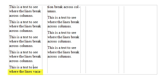

The code above will tell you if the paragraph has a line that hyphenates across a sub column.
The important thing to remember about text items when you use GetText: they always appear in document order. So when you find the SubColEnd in the list, the previous text item has to be a LineEnd, assuming that you just get these item types like line 9.
Here is a screenshot of the document I tested it with. I put my cursor in the last paragraph of the first subcolumn.
