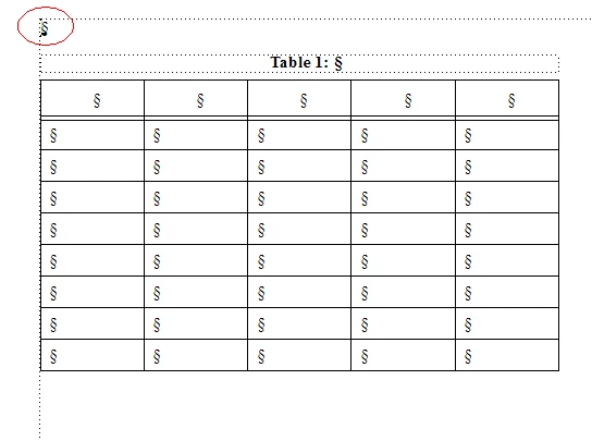

I am on a contract that requires knowledge of Framemaker. I know enough to be dangerous... need help though. How do I insert text AFTER a table? I am using a document created by someone else and muddling my way through this.

    First thing you should do is to turn on the viewing of text symbols (View > Text Symbols, Borders, Rulers) so that you can see where FM is placing things.
    The table is inserted with an anchoring point (looks like an upside down bold "T"). You need to place the cursor after immediately after this symbol and then you can start entering additional text:
    June 4, 2010
    Arnis' advice is correct, but sometimes the anchor is hidden behind the
    table. This happens when the table is given a Space Above number that is
    negative. In that case, you may have to put your your cursor in the line
    above the table and arrow down one line to move your cursor to the line
    holding the anchor point. If you then press the End key to be sure your
    cursor is at the end of the line, you can begin adding text. (You may want
    to hit Enter first, to start a new paragraph to hold your new text.
