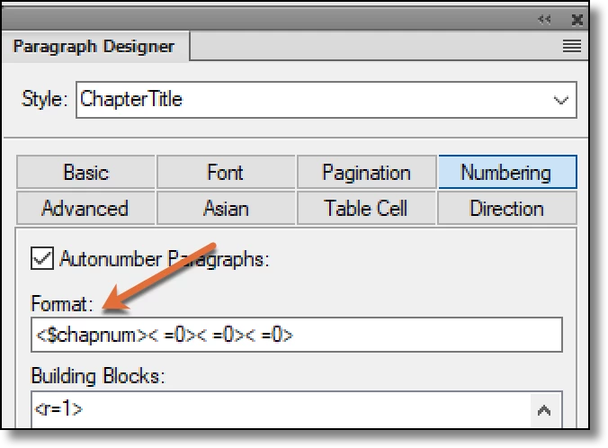

In addition, <$chapnum> is a standalone building block. <$chapnum=1> doesn't work. The <$chapnum> building block is always controlled via Numbering Properties. You can tell it to increment or start at a particular number in the document or in the book window. Always set it via the book window.
In the old days, we didn't have <$chapnum>, so we used the <n> building block (<n> <n+> <n=1>). I was trying to figure out if you had a legacy file that still uses the old numbering system.
These days, we use  <$chapnum> only for the actual chapter numbers, and the <n> for all of the subheading, figure, table and equation numbers.

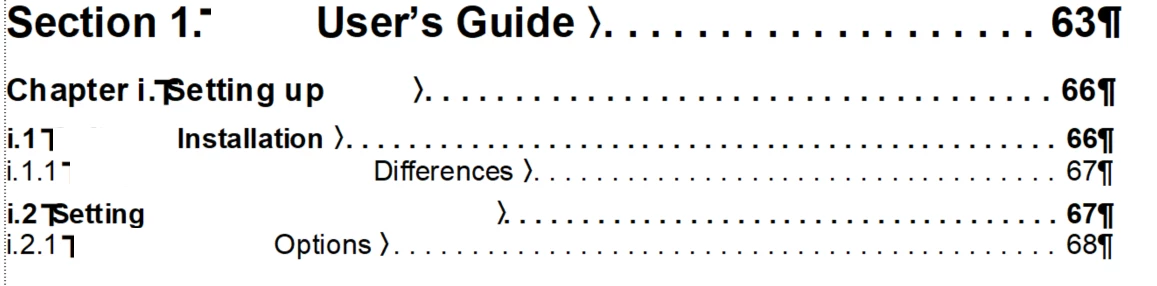

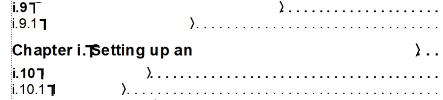

Okay, I've reworked the Front Matter, but the Chapter numbers in the ToC are still botched up. I'll copy in the style boxes and the result, which I will have to redact before posting.
From the ToC:
From a sample Chapter in the book:
The results in the ToC, redacted:
And the next Chapter doesn't get updated for numbering nor having the Headings reset:
The Numbering Properties in both the book and the Chapter file are set correctly. Can you figure out what I'm not getting, here?

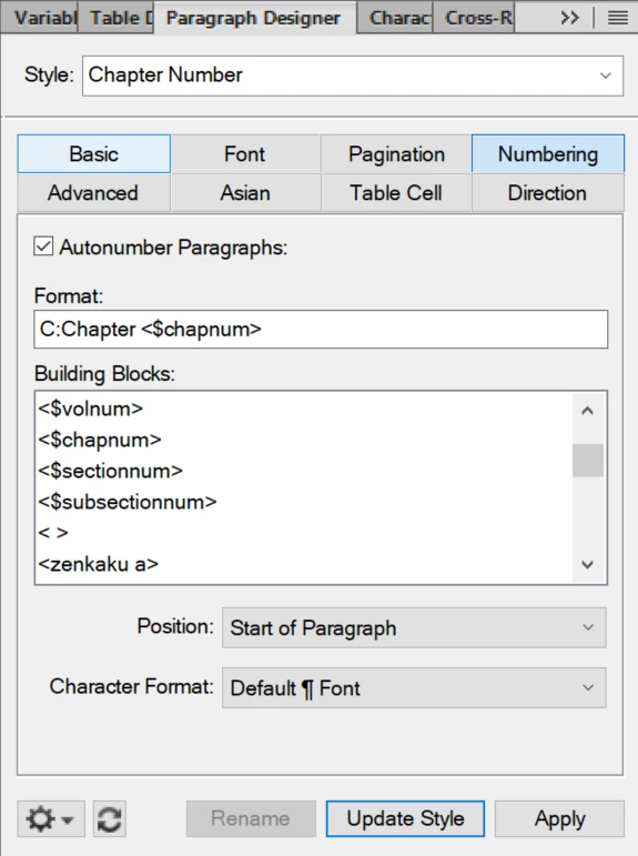

ericb39592353, in one dialog screen shot I spy:
C:Chapter…
and that series indicator C: is not present in another.
If you are using a dedicated counter series, the indicator (which is case-sensistive as I recall) needs to be in all expressions.

Let's go back to my first post. Please share a screen shot of the Paragraph Designer > Numbering with the chapter title (or chapter number) style selected—similar to what I shared.
~Barb

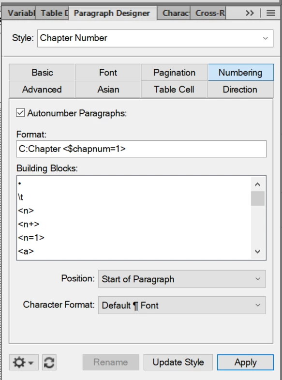

Feb 16, 2021 12:19 AM UTC
Here's what I have in the Chapter file:
I tried adding the argument, "=1" to try to reset it; that hasn't worked.
And here's what's in the Book file. Note that I created a special format to reset the first Chapter in a Section to 1:

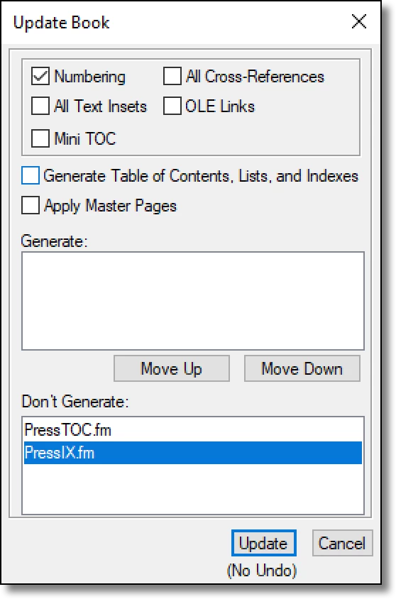

All afternoon? Yikes! It may be quicker to test if you make a few adjustments in the Update Book dialog box. Disable everything but numbering. It should go more quickly. If it works, I'll explain why, and if it doesn't, we can continue onward.
~Barb
Feb 15, 2021 11:42 PM UTC
Actually, I can reply even more quickly. All the Paragraph numbering is set to Restart Paragraph Numbering, just as you have above.

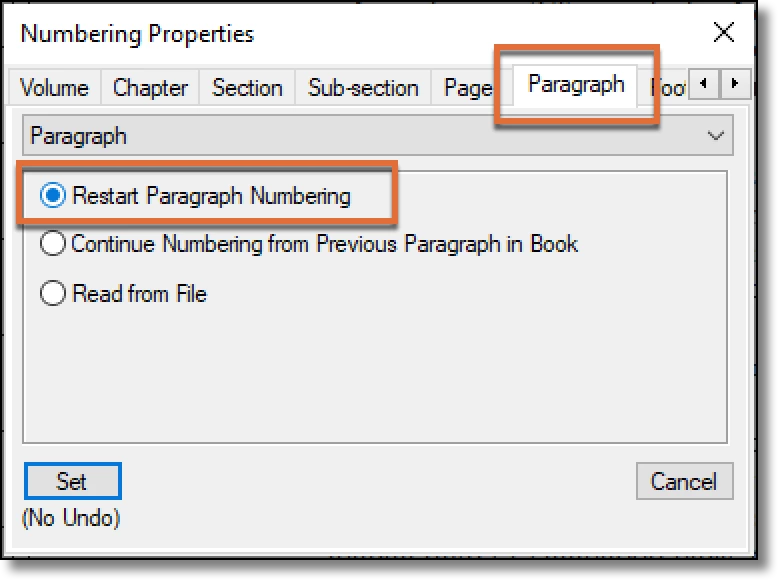

If you aren't using the <$chapnum> building block, changing the counter in Chapter Numbering tab won't do anything. Instead, right click Chapter 3: Frammis Mounting in the book window and set Paragraph numbering to restart. Does that do it?
~Barb
