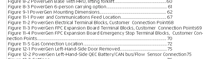

TOC line text is not working right
I guess I want it to wrap to the next line to keep the numbers aligned?

    Your reference page is great.
    You are showing us a different area of the text in the second screenshot. Can you show us the original screenshot after you add the non-breaking space to page 65?

    Hi @virtualtechwriter :
    I would go to page 65 and replace the space between Block and Description with a non-breaking space: Ctrl + spacebar. Then update the book.
    ~Barb
    Mar 20, 2021 9:58 PM UTC
    It did not work using the non breaking space.
    Should there be a \t on the reference page?

    First two thoughts are:
    1. Are the spaces normal or non-breaking in what I'd guess are Table titles?
    2. Is the Tab-R position in the TOC actually at the right edge of the column?
    Mar 20, 2021 10:06 PM UTC
    @1073695 Per Barb I added a non breaking space on the long titles but no luck.
    I do not understand what you mean in #2

    I was just trying to figure out what we are seeing here, and not suggesting fixes. Barb seems to have a more solid handle on it than I do at the moment.
    My #2 question was about whether the column or text frame is actual wider than that tabbing expects.
    Anyway, the way I might work around this is to generate the ToC from invisible metaparagraphs, which are themselves just Xrefs to suitably short Headings/Titles, but would be hand crafted auto-numbered abbreviations for really long Headings/Titles.
