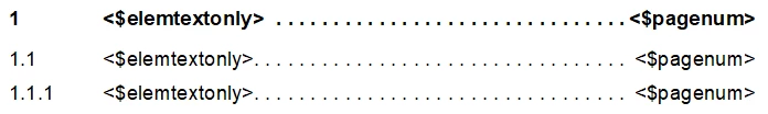

    1. Take a look at the reference pages. The TOC page should look like this:
    Customize it to your wishes., i.e. change the autonumbering of the TOC tags.

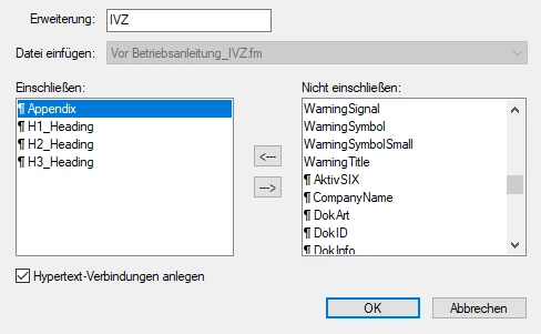

    3. Change the TOC settings. Add all the tags you want to have in the TOC:
