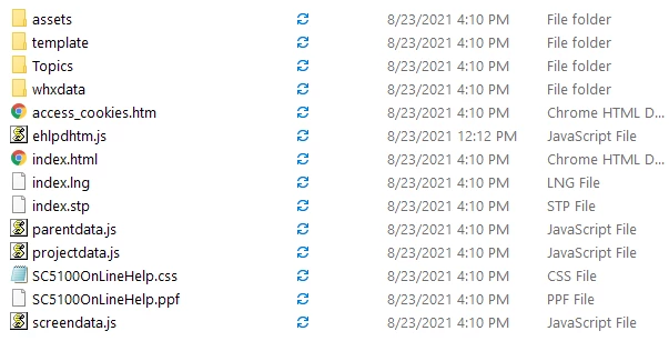

Topics folder name is now capitalized.
Now when I publish my responstive HTML, the topics folder is capitalized. None of the other folders are capitalized. Please help this will create a lot of relinking work.

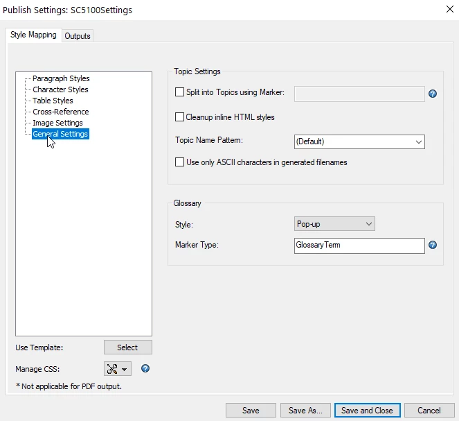

    I have not received a solution to this problem. So what I had to do was take all my stuff back to FrameMaker 2017 and uninstall 2020. I am able to use 2019 and 2017, but can only use 2017 to compile the HTML help for Linux devices.
    So I conclude the issue occurs with 2020. I think I also noticed that in 2020 the selection to place all topics in a single folder is removed. This will cause future problems for me, as well.

    Well the option to keep all topics in one folder seems to be gone in 2020.  Now what?

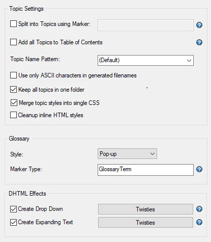

    I'm not sure what that "select to put all topics in a folder" part means - can you show a screenshot of the settings? Don't attach images - just use the Insert Photos icon in the forum interface.

    I started with a new sts file and it still does it as long as I select to put all topics in a folder.
