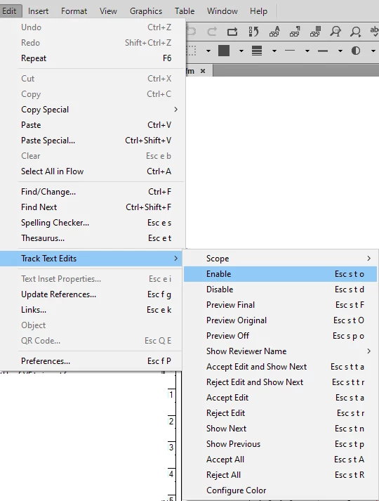

    Hezy A
    May 10, 2020 6:31 AM UTC
    Hi
    to use the track changes menu bar, you need to be marking the changes using Track Text Edits from the Edit menu.
    From Edit, mouse over "Track Text Edits", and choose Enable.
    Then the changes are shown in the text, and not with the change bars.
    Then, the change bar is active and you can accepts or reject changes using the change bar.  When you use this feature, and the change bar is active, you will see Tool Tips when you mouse over, and thus see how it should be used.
