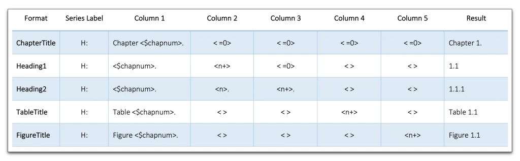

Hi Barb, Thank you for the links they were helpful as well I was wondering if you could give me an example of how that would look in the Format window for the following layout
Chapter or 1, 2, 3, 4, etc
Section 1.1, 1.2, 1.3, etc., 2.1, 2.2, 2.3, etc., 3.1, 3.2, 3.3, etc., 4.1, 4.2, 4.3, etc.
Sub Section 1.1.1, 1.1.2, 1.1.3, etc., 2.1.1, 2.1.2, 2.1.3, 2.2.1, 2.2.2 etc.
Sub Section with Roman Numeral  i, ii, iii with roman numerals restarting each time they are used so if I have roman numerals in section 1.1.1 and 1.1.2 they start at i each time they are used
With figures I am trying to include the Chapter, Section, and figure number so the 1 Figure in Chapter 1 Section 1 would show as Figure: 1.1-1 figure 2 in the Same section would be Figure 1.1-2 then in subsequent Chapters and Sections show the current Chapter and Section ie Figure 2.1-1 or Figure 3.2-1 (Chapter 3, Section 2, Figure 3)
With the Complexity of this the <$chapnum. <$sectionnum> <$subsectionnum> seems like a cleaner alternative to <n+>< =0>< =0>< =0>< =0> format. Thank you again for your help I am already closer to the goal than I was with the info you already provided.
November 19, 2019
Whenever you leave out a placeholder in a series, < =0> is implied. That is what was resetting your Figure numbers. You need the < > placeholders so that your Figure and Table titles don't reset.
So like the table that I copied from @BarbBinder's blog post indicates except column 1 would be replaced with <n> <n+> etc.? In my current document the figure numbers are counting towars the section counter. In order for this to not be the case would they need to be their own series? Or is there a way that I can set them up to number seperately i.e the Chapter Section numbering that works

If your figures number consecutively within a chapter and aren't dependent on the sections, etc., you can put them in their own series.
F:Figure <@chapnum>.<n+>

What building block are you using for the chapter number? If you are using <$chapnum>, you set this at the book level. Right-click on the first chapter in the book window and choose Numbering. Set the Chapter number to start at 1. Then shift-click the rest of the chapter components and choose Number. Set the Chapter to Continue from previous (or whatever it says). Then when you update the book, you will get the correct chapter numbers.
If you happen to be using <n+> building blocks for the Chapter number, then you have to go to the Paragraph tab in the Numbering Properties dialog box and set it to Continue Numbering from Previous Paragraph in Book. I don't recommend this though; using <$chapnum> is better because it is self-documenting and easier to control at the book level.
