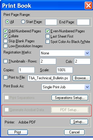

I'm trying to print a FrameMaker 9 file to PDF, but the "Generate Acrobat Data" field and the PDF Setup button are both disabled - meaning I cannot select or unselect either. How can I get these re-enabled?

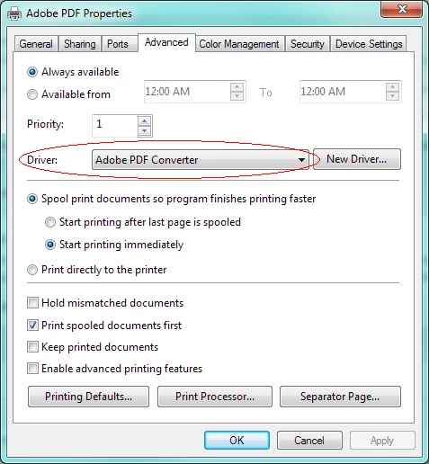

This is exactly what happens when FM detects a non-postscript printer as the output device.
Check the printer setup being used in FM. Even if it says "Adobe PDF" in FM use the Printer Properties panel to be certain that it is actually using the Adobe PDF Converter driver.

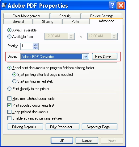

Arnis, I double checked the printer. I got to a screen that looks similar to yours and it does say Adobe PDF Converter driver. But it's interesting that you say this is what happens when it detects a non-postscript printer. Could the driver be corrupt or something?
