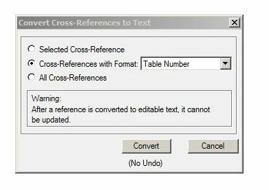

I don't know what your workflow looks like, and this might add another step, but.... You could maintain the master document with the xrefs, so your text references will update, but before you publish to HTML5, convert the xrefs to text. In the Cross-Reference pod, click "Convert to Text..." and then select the unique xref format in the dialog:
Work in a copy of your master doc (or quit without saving after you publish) to preserve the live xrefs for future updates.
