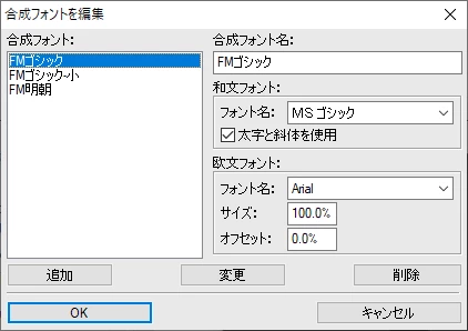

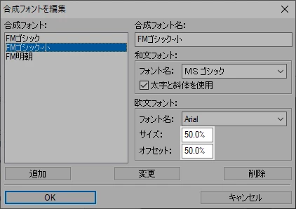

When using a composite font in the Japanese version of FrameMaker 10, the underline was connected to one line as shown in the screenshot.
1. Create a composite font for regular text.
2. Create a composite font for superscripts.
3. Apply the composite font from 1. to the paragraph.
4. Apply the composite font from 2. to the superscript character format.
5. Apply underlining where necessary.

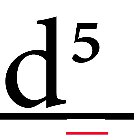

If you are using Unicode-supporting FrameMaker 8 or 9 and a font with the necessary glyphs, you can use the designated superscript characters, they are treated like regular characters for underline purposes (see image, the font is Minion Pro).

Apr 28, 2010 7:50 PM UTC
Good catch on the superscript numbers from the font, Michael, I'd forgotten about them.
However, I see a slight variation in the positioning of the underline; it's only visible at higher magnifications (800-1200), do you see it too? I'll post a screenshot below (hopefully it's not too huge for displaying...) This is Minion Pro.
4everJang
Sep 19, 2022 4:44 PM UTC
Have you set the superscript scaling to 100% ? If not, that might cause the slight downscaling of the underline. Just a thought...
