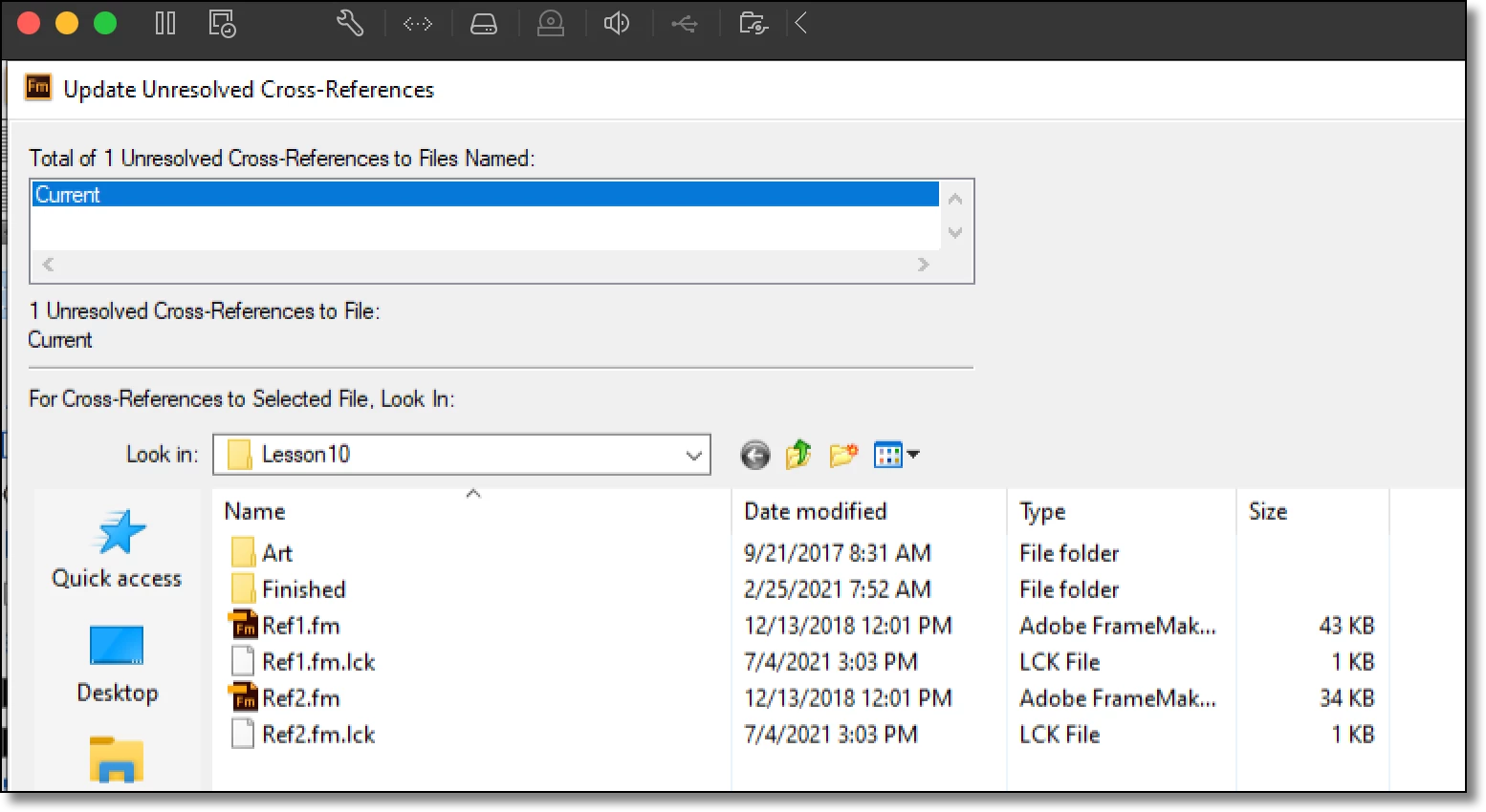

    You are not alone. IMHO, this is the least intuitive dialog box in the Fm interface. 😩
    Click the file with the unresolved x-refs at the top of the dialog box, under Total of X Unresolved Cross-References to Files Named:. Then double click the file where the reference was moved to in the For Cross-References to File, Look In: section. Fm will match up the marker to the reference and resolve the reference.

        Try Edit > Update References. There's a Commands pull-down menu in the upper right corner of the resulting dialog box. Select Update Unresolved Cross-References. That command brings up another dialog box which tells you which files have unresolved cross-references and helps you correct some errors. For example, you can change the file that contains the source. Good luck.

    OK, I get the first part. I can open the dialog box that asks "For Cross-References to Select File, Look in:" after that, I'm stuck.
