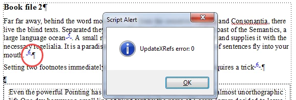

Dear friends,
My whole script now works fine with the exception of the XRef update after inserting a new XRef. It works correctly if the target of the XRef is in the same file as the XRef (oDoc == oTgtDoc). Both files are open at the time of the update - and the active document is that with the XRef (oDoc).
→ What may be the problem here?
The blue XRefs all work correctly and point to a separate file (\endnotes). Manual updating with the GUI is OK, but why does this not work in the script?
//                                            --- Build new XRef and insert it at saved location
  Fno_SelectParagraph (oDoc, oPgfNew);            // Required
  oTgtTL = new TextLoc (oPgfNew, 0);
  Fno_RestoreLocation (oDoc, oUserLoc);
  oTL = oUserLoc.txtRange.beg;
  oXRef = Fno_InsertXRef (oDoc, oTL, sXRefFmt, oTgtDoc, oTgtTL);
  oDoc.UpdateXRefs(Constants.FF_XRUI_EVERYTHING); // note done in book files !!!!!!!!!!
  alert ("UpdateXRefs error: " + FA_errno);
