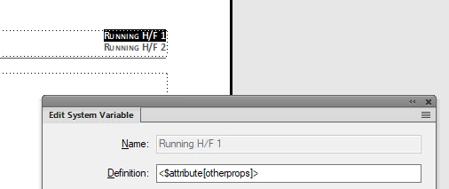

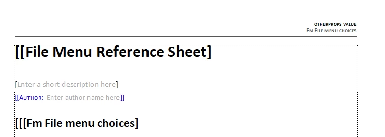

    Mar 17, 2022 1:13 AM UTC
    Not sure what you're missing.
    I edited my Running H/F to use that exact <$attribute[otherprops]> string and it worked fine for me in an open reference topic.
    It may be that your definition is actually working...Do you have an ancestor to your element with otherprops that doesn't have any content specified in otherprops?
    -Matt
    -Matt Sullivan, FrameMaker Course Creator, Author, Trainer, Consultant
