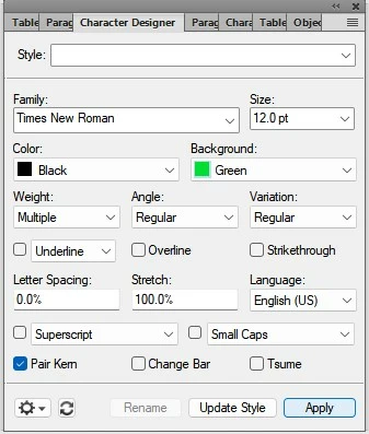

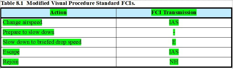

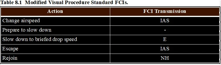

I trying to apply the "None" background (Character Designer) to tables in a document.  Some searches I run leave text within the tables with background highlighting. While I can select the entire document and apply the "None" background to the body text, it doesn't change the highlighting in the Tables.
I have a script that steps to each table in the document and selects it, but can't figure out how to apply the desired background color after it's selected.  Any suggestion?

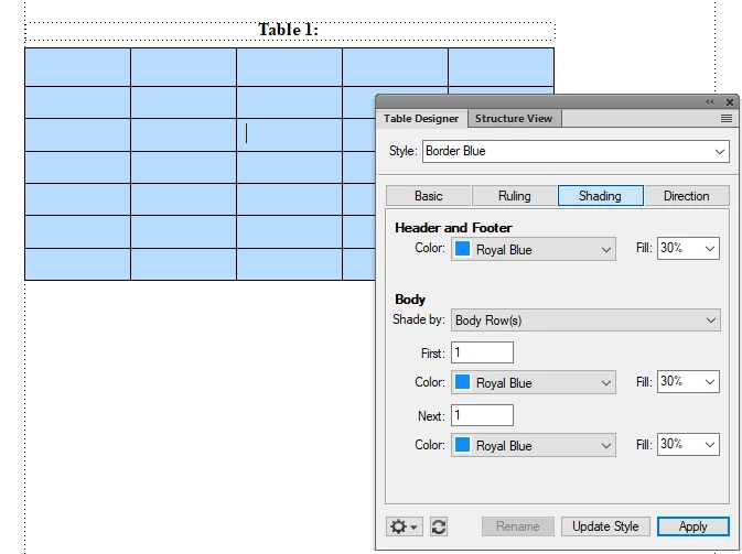

frameexpert
Jul 20, 2022 5:57 PM UTC
Look in the Table Designer to see how you apply shading to the entire table in the FrameMaker interface. You do it by shading rows or columns, not the entire table at once. To shade the entire table, you need something like this:

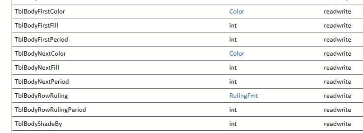

You do the same thing programmatically using these properties:
Instead of processing each Cell object, you are processing properties of the entire Tbl object.

Fightergator
Jul 20, 2022 6:53 PM UTC
Rick...If |I manually select the entire table (see below) then go to the Character Designer and apply a background color, it background colors all text in the table in one action without stepping through each column or row. I may not have explained it right (I wasn't look trying to shade each cell).  I'm to background color all the text in the table...Character Designer --> Background --> Apply.
