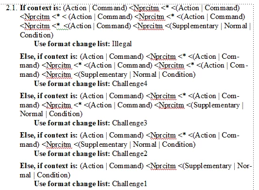

Page 257 of the "Developing Structured Applications" Guide (2015) covers the use of OR indicators within a specification for a Context Rule.
I have attempted to make use of this with the following:
This appears to work OK when All the (Action | Command) tests finds all Action elements or all Command elements.
Action
               Action
                              Action
                                             Action
Or
Command
                    Command
                                        Command
                                                            Command
However if the results a mixed e.g.:
Action
               Command
                                       Action
                                                       Action
The rules seem to work on the first element in the (Action | Command) pair i.e. It finds the first Action element but fails to find the second Command element.
Is this a feature or a bug?

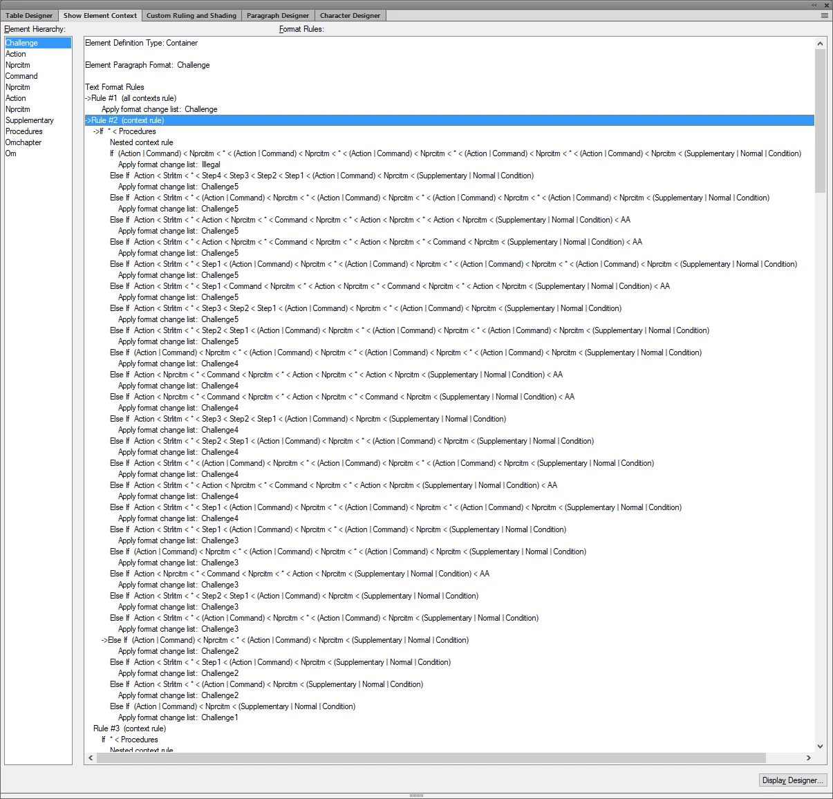

Timothy,
   Can you send a screen capture of the Show Element Context window when the insertion point is in an element that does not format properly? You can open this window with Structure > Show Element Context.
    Meanwhile, over the weekend, I will try to find time to create a test EDD based on the information you have provided and see if I can duplicate your problem.
     --Lynne

Here is the relevant set of rules you requested.
You should note that anywhere you see <AA means that the rule will not work <AA is a test rule I am using. In this case I hadcreated some rules to work around my problem. However they provide an indication where the OR cases fail.

Timothy,
    First, I created a test case that is much simpler than yours. I found that context specifications such as:
        (s1 | s2) < * < (s1 | s2) < * < (s1 | s2)
sometimes work and sometimes don't, even when used to format an element that has both s1 and s2 ancestors. However,
    (s1 | s2) < (s1 | s2) < (s1 | s2)
worked (although it might not be what you want to test). Also,
    s1 < * < s1 < * s1
also worked in all my test cases. Thus, the problem isn't just the OR indicator, the wildcard, or a context involving different types of ancestors. I was unable to come up with a description of what causes the failure.
  I filed my test case with bug FRMAKER-6701.
  Second, your context rule is unusually complicated. Is it necessary to explicitly list so many ancestors? When elements can an asterisk represent? Depending on the way your various elements can nest, you might be able to use a level rule instead of a context rule. Based on your initial message, I tried a test using the element definition:
