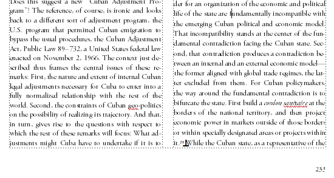

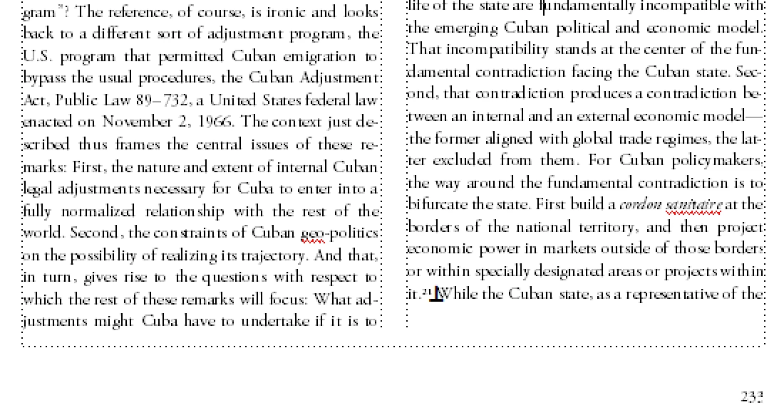

    Tell us more about your vertical alignment requirements. Are you trying to center-align text vertically within a frame or are you trying to justify multiple lines within a frame, so that the first line is at the top of the frame, the last line is at the bottom and FrameMaker feathers the spacing of all the lines in between? The latter is a feature in FrameMaker using Format > Page Layout > Line Layout > Feather.
    Before enabling feather:
    After enabling feather:

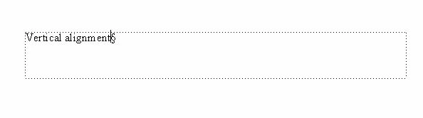

    Hi Barb,
     see the above pic. here i can control horizontal alignment by using paragrah designer but my requirement is need to align text vertically like center, bottom. in indesign it is possible so is there any way to do in framemaker??
    Bob_Niland
    September 10, 2020
    For infrequent instances, you can use a borderless table cell. FM Tables have support for top/middle/bottom, and you can control cell height.
