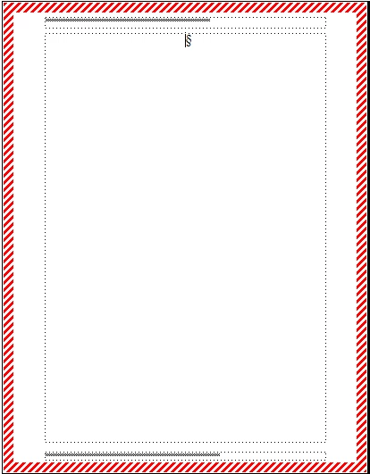

    Thanks for the feedback. Good point about the links, I wasn't thinking about that. One of my problems with the PDF that FM created was it made my diagonal red page border come out as a solid red border. It is a requirement that the book have this diagonal. My FM master page shows it correctly and if I print a page from the FM file it prints correctly. I need to know how to make the PDF show the page border correctly. With Microsoft Word, sometimes if I print just the section that has a special border and replace the page in the PDF, all is well. But in this case, I also need the links to work.

    You can also use Acrobat's Watermark or Page background features to add a PDF of such a border layout that is placed behind or on top of the current page with user-defined transparency levels. This way you don't have to make any chnges in FM, but it can be a mantenance issue, as you have to remember to do it every time you create the PDF.
    FM's line patterns don't always match what you see (the postscript code is interpreted before output and some results are hard-wired). The best approach is to create the diagonal-lined border in a program such as Illustrator, verify that it looks correct in a PDF output and save it as an EPS. Then place the EPS as the background on your Master page. FM will pass the EPS code straight through and not try to interpret it.
