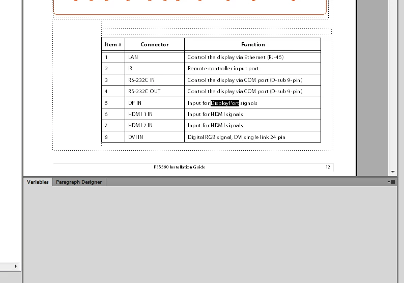

I wrote it wrong. I can't see the Variables listed in the Variables Pod on a Body page. I can find them in Find > Any Variable. I have not scrolled through the Variables Pod, because there are NO variables there. No system variables, no custom variables. If I double-click on a variable in the Body page, nothing happens. Note the highlighted variable in the picture.

Very strange. It's not that your variables are not listed, but the whole content of the variable pod with the icons is not shown.
