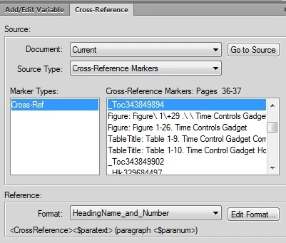

I am working in FM11. I have a bulleted list of my heading 2 name and numbers. When I add a cross-reference for source type Paragraphs and insert my heading 2, select my reference format for HeadingName_and_Number, it changes to a cross reference marker. I am trying to copy and paste one heading (with name and number) and select that one to quickly increment the heading until I go through the list. This works in some of my other chapters, but keeps changing from paragraphs to cross reference marker. How can I make it stay a paragraph cross reference? Thanks again for your help.

At the start of a section I have a hyperlinked list to the major sections as shown in the first image:
If my sections have changed slightly due to software upgrades and enhancements, the names have changed. In other sections in the same chapter I am able to copy and paste the first hyperlink (in this case it would be the Time Controls line). Then I paste it 4 times and double click to select the next new upgraded paragraph name. I set these with the cross-reference tool and select Source Type: Paragraphs. I choose Marker Types Heading2 and click Insert. Then immediately it goes back to marker types Cross-Ref instead of Paragraphs as shown in the second image:
Other similar groups keep the Paragraph marker type so it is fast and simple to copy + paste and select the updated heading to link. I don't understand why this set won't keep the paragraph marker type.

This is normally a sticky setting in the Cross-Reference window, i.e. FM remembers the last setting that you used and IIRC, it may be per document.
When you say "it changes to a cross reference marker", what exactly is "it"? The Source Type setting? I don't exactly follow what you're doing from your explanation, especially the bit about quickly incrementing the heading.
