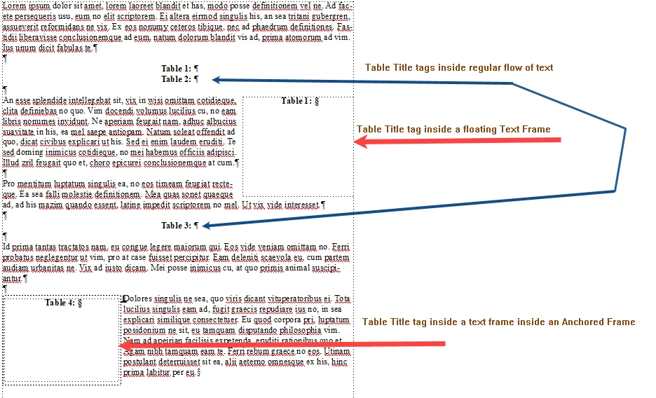

    There's usually a way around it, yes. I haven't actually done this before, and didn't have time to do a lot of testing. I just found it odd that if you put the table inside a text frame, the autonumbering got disconnected, but if you put the table inside a text frame inside a graphic frame, it incremented.
    Testing consisted of inserting a paragraph with the table title tag inside the main flow followed by a table title inside a text frame, followed by a table title inside a text frame inside an anchored frame followed by a table title inserted in a paragraph. The table title inside the anchored frame incremented. The one inside the text frame restarted.
