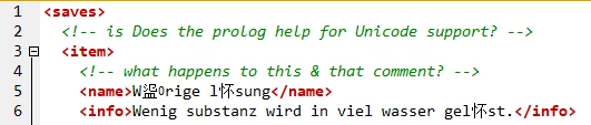

When running this program step by step I see the internal presentation
After writing I see in the file (it is still UTF-8 with BOM):
  1. Where is the prologue?
  2. Why do I have Chinese characters? The strange characters actually are u4000, u07C0 and u6000.
  3. What is UNICODE good for XML if it is necessary to use entities for all but the ASCII characters?

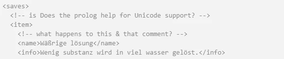

Before running the script I checked the output file: it exists, is empty, is UTF-8 with BOM (and hence is 3 bytes long).
After the script run the file is Windows Code Page, but contains all items except the prolog:
<saves>
  <!-- is Does the prolog help for Unicode support? -->
  <item>
    <!-- what happens to this & that comment? -->
    <name>Wäßrige lösung</name>
    <info>Wenig substanz wird in viel wasser gelöst.</info>
  What the heck is going on here?

Dec 14, 2020 3:00 PM UTC
Thanks Klaus,
I completely forgot that in the WriteXMLdata function I always create a new new file to write the full XML structure.
And now I get what I want, even if the input file does not have a prolog:
<saves>
  <!-- Does the prolog help for Unicode support? -->
  <item>
Klaus, you are a great mind-saver!
