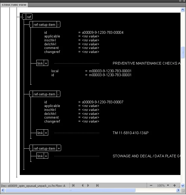

When exporting to XML "File-Save as XML"
FM does not export all the information. Below is the the Structure view:
The XML output from this is:
<ref>
<ref-setup-item id = "o00009-9-1230-783-00004">
<link local = "m00003-9-1230-783-00001" id = "m00003-9-1230-783-00001"></ref-setup-item>
<ref-setup-item id = "o00009-9-1230-783-00007">
<link local = "s00001-9-1230-783-00050" id = "s00001-9-1230-783-00050"></ref-setup-item>
<ref-setup-item id = "o00009-9-1230-783-00010">
<link local = "o00031-9-1230-783-00001" id = "o00031-9-1230-783-00001"></ref-setup-item></ref>
As you see the "link" element text is missing and is not closed...any thoughts?

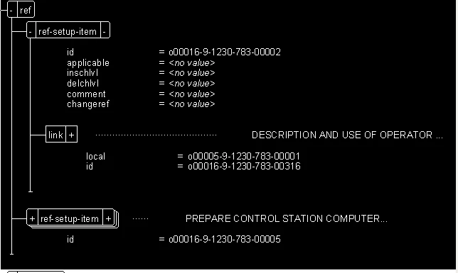

Ok this is the setup I have in the EDD:
I removed the r/w rules...
now I cannot add the title element to the document! I imported the EDD...still no luck...the element is just like it was before...any thoughts.
EDIT: Never mind...just added another link element...

Ok. I think I know what the problem is.
The problem is in the Read/Write rules. The "title" element is part of the cross-reference structure, but is not being exported.
The read/write rules currently being used for the "link" element is:
element "link" {
   is fm cross reference element;
What do i need to do to force FM to add the title element
I tried
element "link" {
   element "title" is fm element;
but this generated an error...any thoughts?
Michael
August 18, 2010
Hi Michael,
Looks pretty weird.., Framemaker cross reference - type elements cannot have content, their counterpart in XML must be an empty element. R/W-rules cannot create element structures, so you cannot create the title-element from thin air.
What is your DTD definition for the cross-refrence structure?. What should the title-element contain?
BR, Martti

August 16, 2010
Is link-element a Framemaker cross-reference element?. If so, the element content is left empty during xml export. If not, check the r/w rules associates to structured application used for link element.
Hope this helps,
Martti
