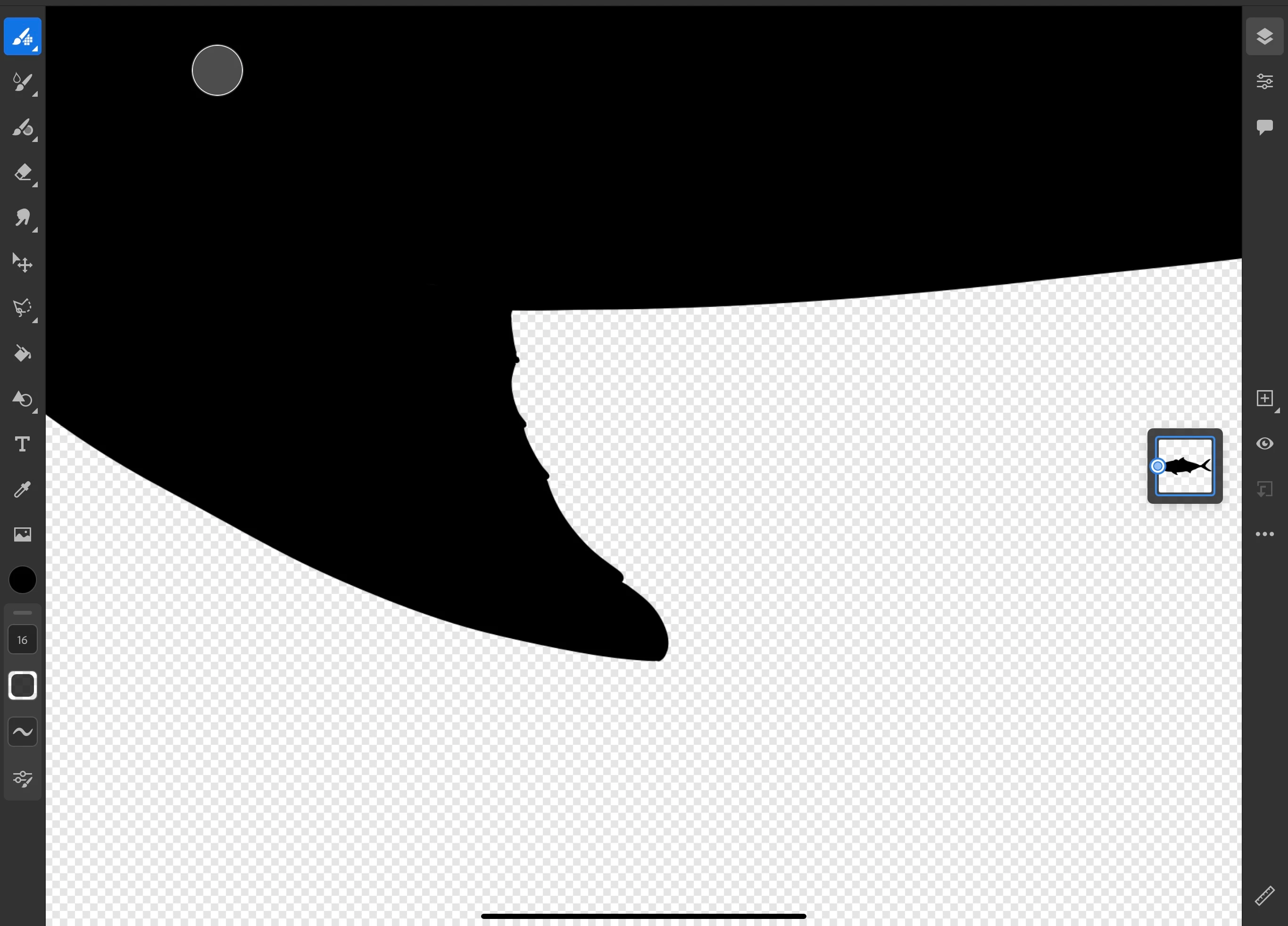

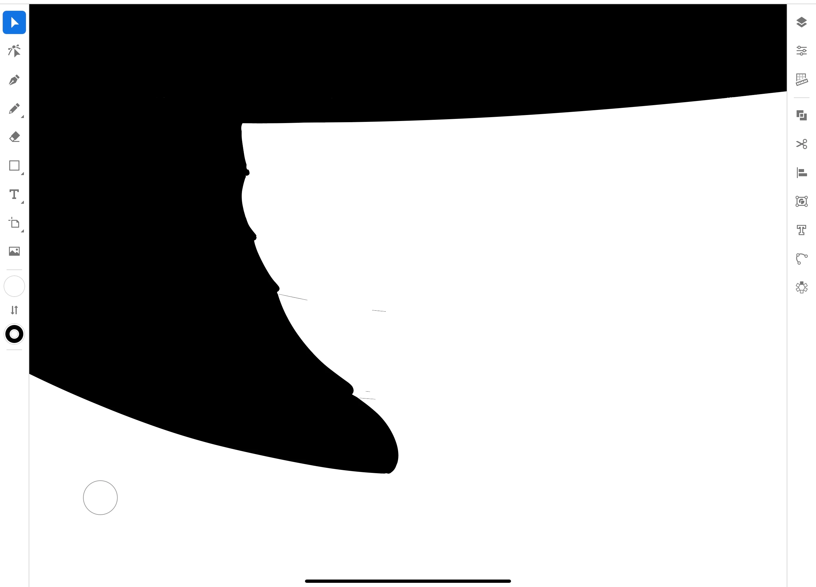

I've been drawing with vector brush on iPad in fresco, then export it to PDF. Take the file to my desktop and open it in Illustrator.I notice on my line art that there are extra points and lines that weren't visible in the fresco drawing. This happens primarily where I used the trim tool (where I've done a bunch of overlapping hatching and used touch tool/pull for that that light line that trims the excess). It seems when I trim, Fresco doesn't actually delete the excess line, and it doesn't show until I I open in Illustrator.
I've tried using experimental simplify, and to merge all my layers. I've also tried the merge and outline tool in Ilustrator and Path> create outlines, simplify, and clean up. But there seems to be no better way to get rid of these extra vectors without going around and individually selecting them and deleting them, which is very time consuming and I'm afraid I'll miss a point.

I appreciate your explanation, but I think you misunderstood the problem. It has nothing to do with the fact that fresco creates fills not lines. I've create a series of screenshots to better illustrate the problem. It is attached. Here's the explanation for each frame, top to bottom:
1: Create new file in Fresco, draw a circle using a vector brush
2: draw some hatch lines with vector brush that overlap the circle
3: use trim tool (press and pull modifier button and draw with pencil)
4: top hatches trimmed to shape of circle
5: Use trim tool on bottom hatches
6: bottom hatches trimmed to shape of circle
7: export file to pdf
8: open same pdf in illustrator
9:Observe remnants of trimmed lines (technically fills) visible in Illustrator that weren't visible in Fresco
(NOTE: the red lines were added to screenshot to highlight the problem, the PDF has NOT been edited in Illustrator)
10:More remnants that weren't visible in fresco, red line added afterwards to highlight problem.
11: Choosing direct select tool (arrow touching a Bézier curve) highlights the extra points that were supposed to be deleted using trim tool earlier in example.
Thanks for any help! With this file it would be easy to go around with direct select and delete the offending marks,  but in a more complicated file that could end up very time consuming.
