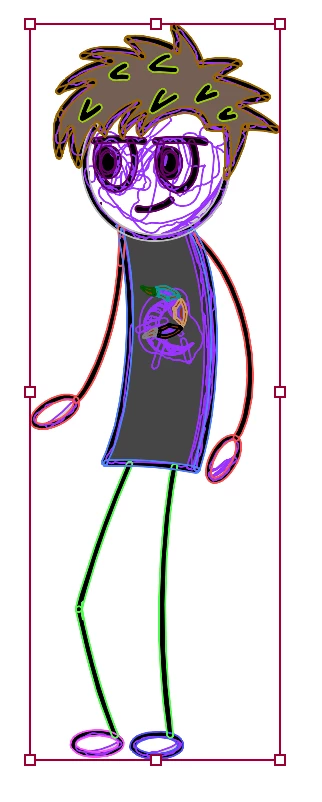

I have some avatars I've created using Fresco and want to then put them into indesign for a book I am writing. I am drwaing them freehand and using the fill tool. However, I notice that as I'm drawing, erasing things, using the fill tool etc that there seem to be a lot of anchor points and extraneous information that carries over when I open the files in illustrator. My teenage son (untrained) did a clean up by redrawing them and he said not to use the fill tool, to instead use the brush to fill in the color. Which seems like a lot more work that I'm not sure is necessary. However you can see the difference between the original version on the left (mine with multiple iterations), and his.

Sep 25, 2022 10:04 AM UTC
