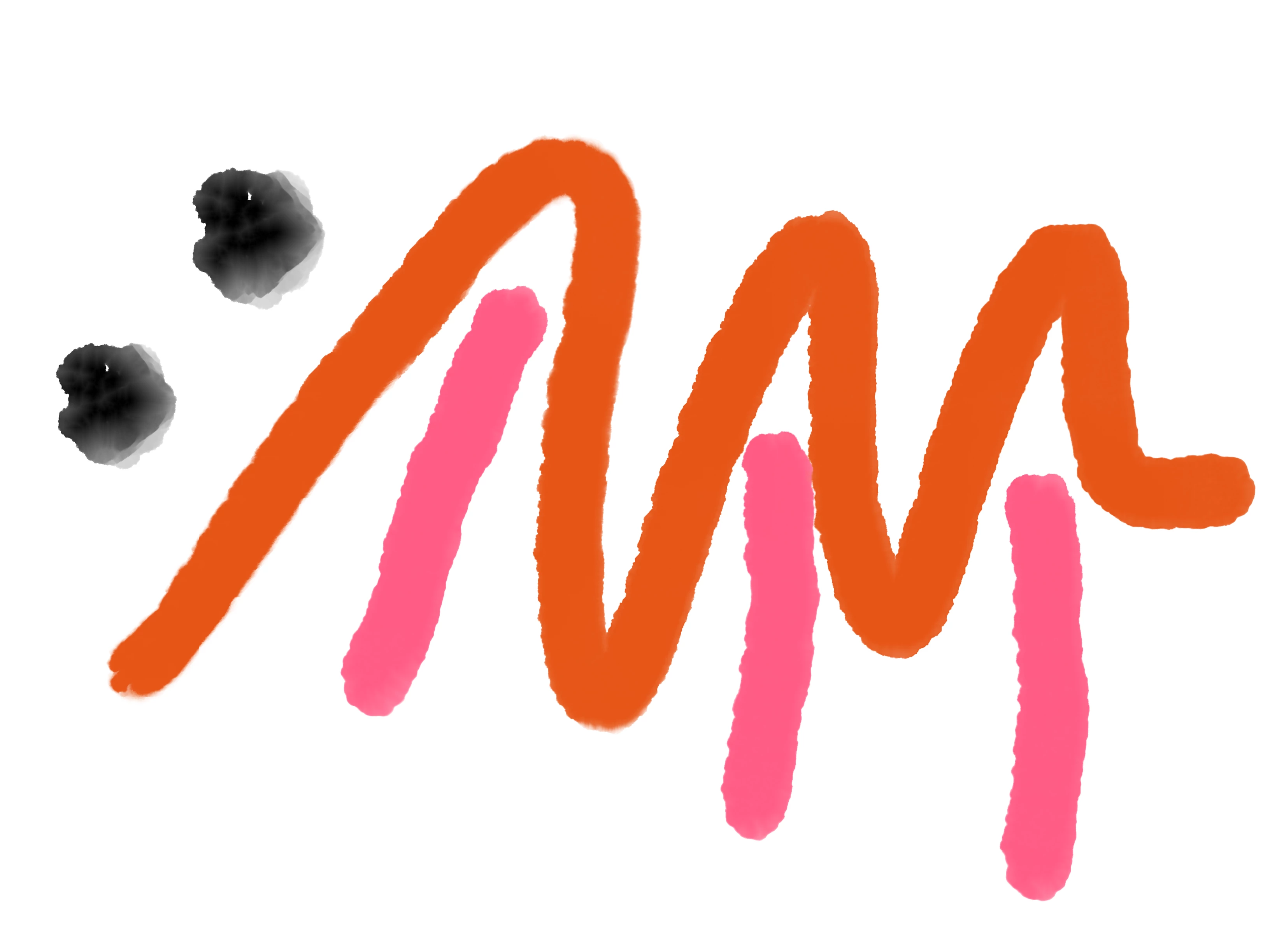

Live Watercolor Wash Soft Brush Leaves Marks
When I use the live watercolor wash soft brush, it leaves white marks.  I've attached a picture as an example.  Look at the black circles on the top left.  Inside the black, there are white marks.  It's using the color of the background to make the marks.  How do I fix this, or is this a bug?  I apologize if this has already been asked.  I searched for this question but didn't find a post about it.

Sorry for being late in answering! I looked at this in Fresco, and that soft wash brush tip does have an opening there, just from the irregular shape of the tip. I could only reproduce that it when I turn the water flow all the way down to zero and press to make a darker a tip print. If you are making washes, it should not show up. Add water flow to the brush at the bottom of the tool panel.
