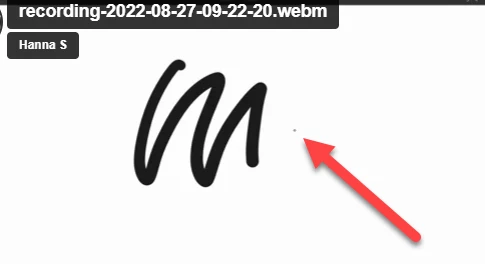

Random blotches appear mid screen when I Ctrl+Z
  • August 26, 2022
  • 21 replies
  • 1597 views
I'm currently using a Wacom Intuos with Fresco 3.8.1. Yesterday it was all good, but today whenever i "undo" a blotch appear mid screen as if I just made a dot with my pen. It looks like which ever brush I'm currently using. It happened occasionally before the update too but now it happens almost every time, I'd say problably 80% of the times I Ctrl+Z. Very frustrating and it makes the drawing experience extremely disruptive. Anyone else having this or a similar problem? Any ideas towards a solution?

December 16, 2022
I also have this problem and it only happens in Fresco.
It has something to do with my mouse cursor.
The only work around I found was to move the cursor with my mouse onto the sidebar of Fresco (off the artboard). If you have two screens and you place your mouse cursor onto the second screen, by default, it will create a spot on the middle of the artboard. Weird....
Fresco needs an update to fix this bug
Hope this helps

Michael J. Hoffman
August 28, 2022
Do you have a Wacom mouse sitting on the tablet, in addition to the pen? It looks like a second device is providing input but just sitting in a static position. I have seen behavior like this in Photoshop, so just wondering.
Before the blotch appears, and while you're drawing, it appears there is a second device cursor just sitting there, right where the blotch appears.
