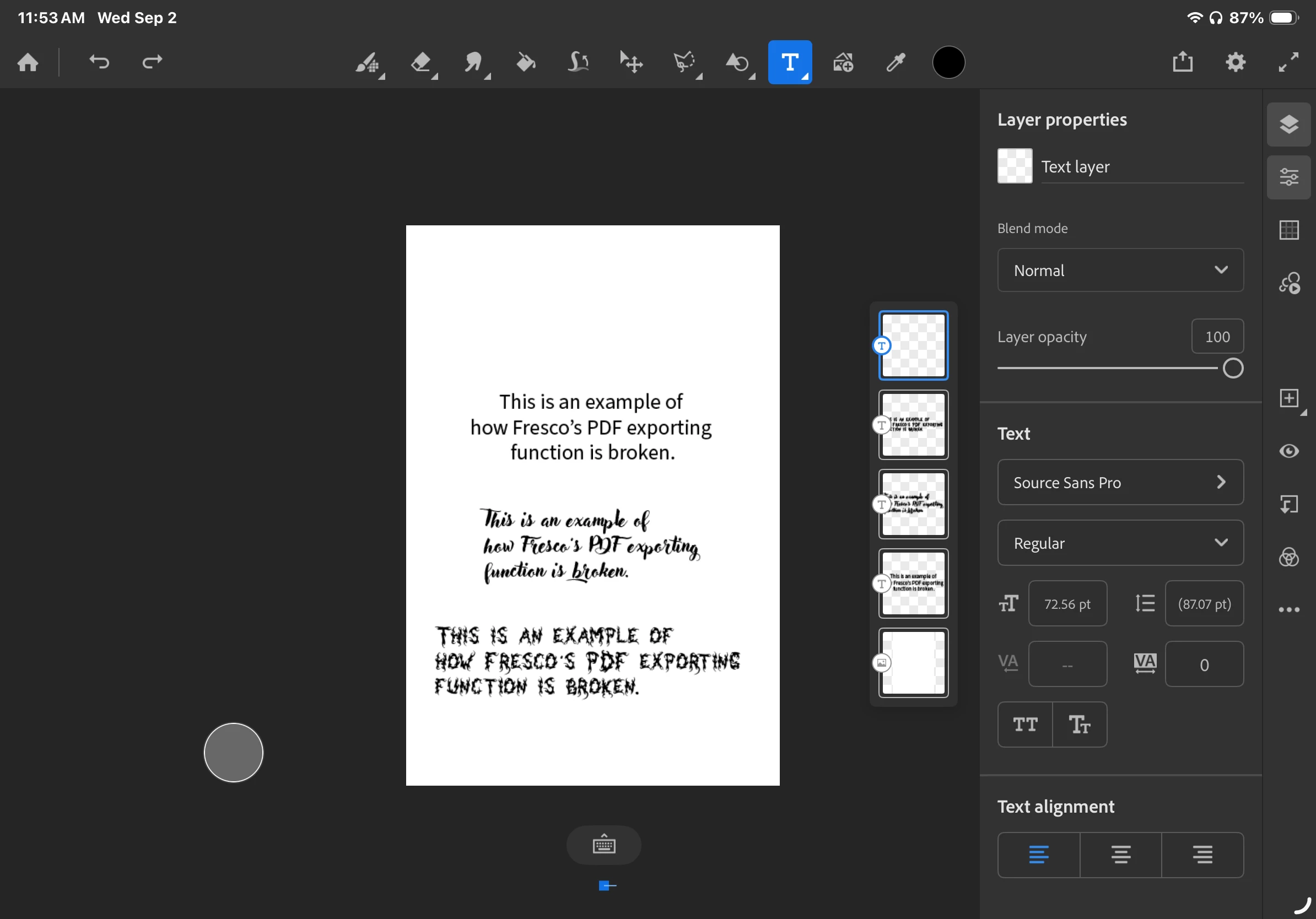

I am experiencing a serious export problem in Adobe Fresco on iPad.
My text looks completely correct within my Fresco documents. However, when I export the document as a PDF, the text becomes distorted.
I have tested multiple documents, including older Fresco files that previously exported correctly. Both my old and newly created files now experience the same problem, which makes me believe this may be related to a recent Fresco update or change to the PDF export process.
I have also tested other export formats:
  • JPEG: text appears correct.
  • PNG: text/artwork becomes blurry, even when using the highest available resolution.
  • PSD: the exported file is also blurry.
  • PDF: artwork may be present, but the text becomes distorted.
  • Changing the font does not resolve the PDF distortion.
The same Fresco files did not have this problem previously.
Could the Fresco team please investigate whether there is currently a PDF export/rendering bug? I would also like to know whether there is a way to install or test an earlier version of Fresco on iPad to determine whether the previous version exports these files correctly.

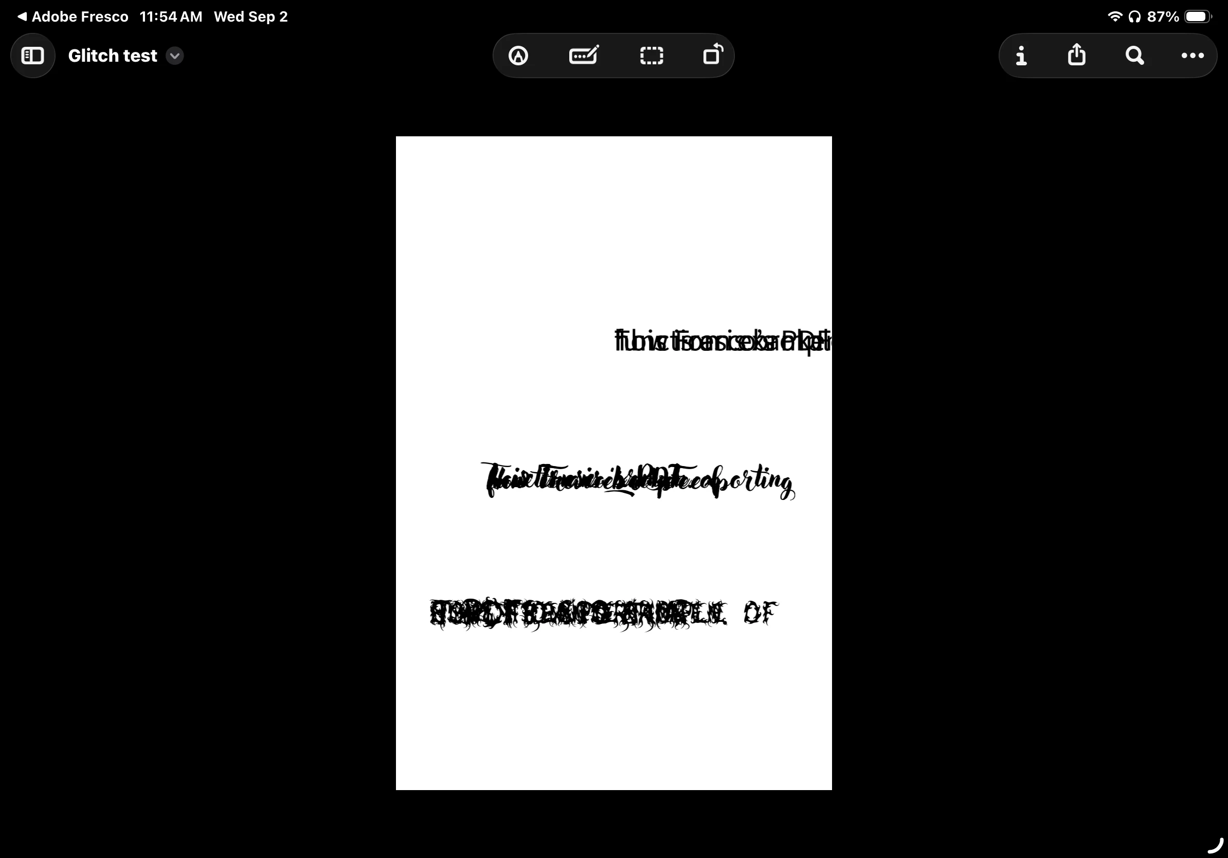

    I am having the same issue saving a pdf with text. Have tried to export as psd to try and get around the issue, but it fails each time.
    Sep 8, 2026 10:32 PM UTC
    It's still happening for you? When you said PSD did you mean the text is still messed up as a PSD file too? I found that the last update (where they've changed the brush settings interface) fixed it the day after I replied to this thread

    Sep 2, 2026 6:59 PM UTC
    PSD is normal, but my PDF files with text lose their position and line spacing. I tried restarting the app and iPad but it didn’t help. My iPad is Pro 11 with OS version 26.6.1
