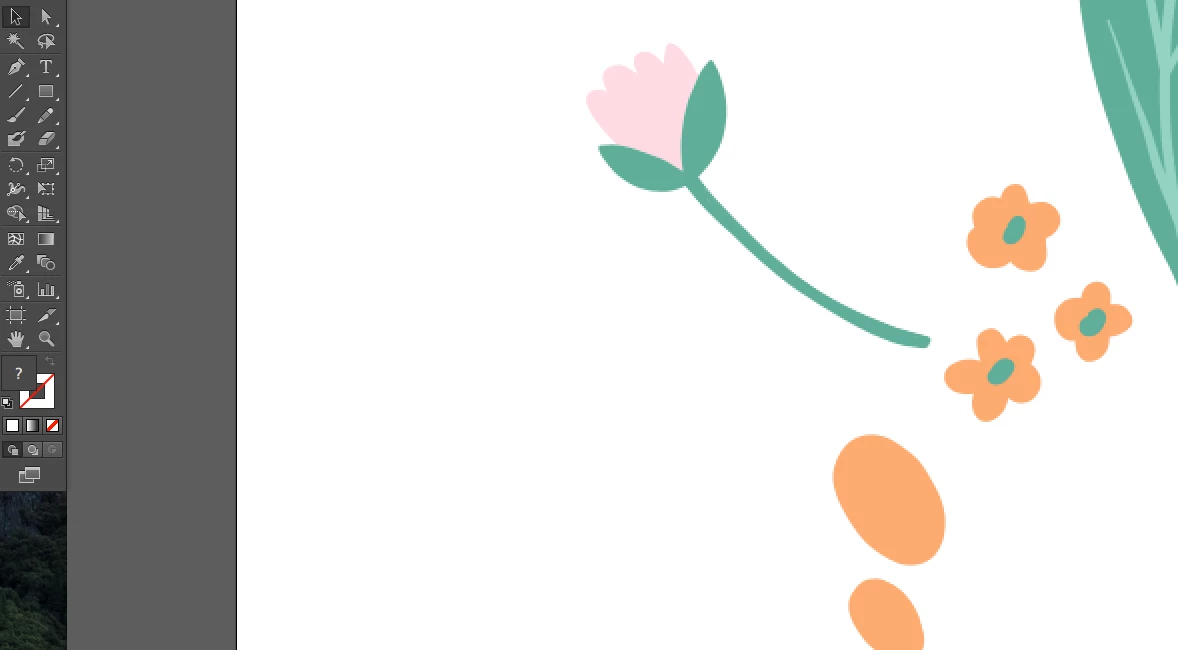

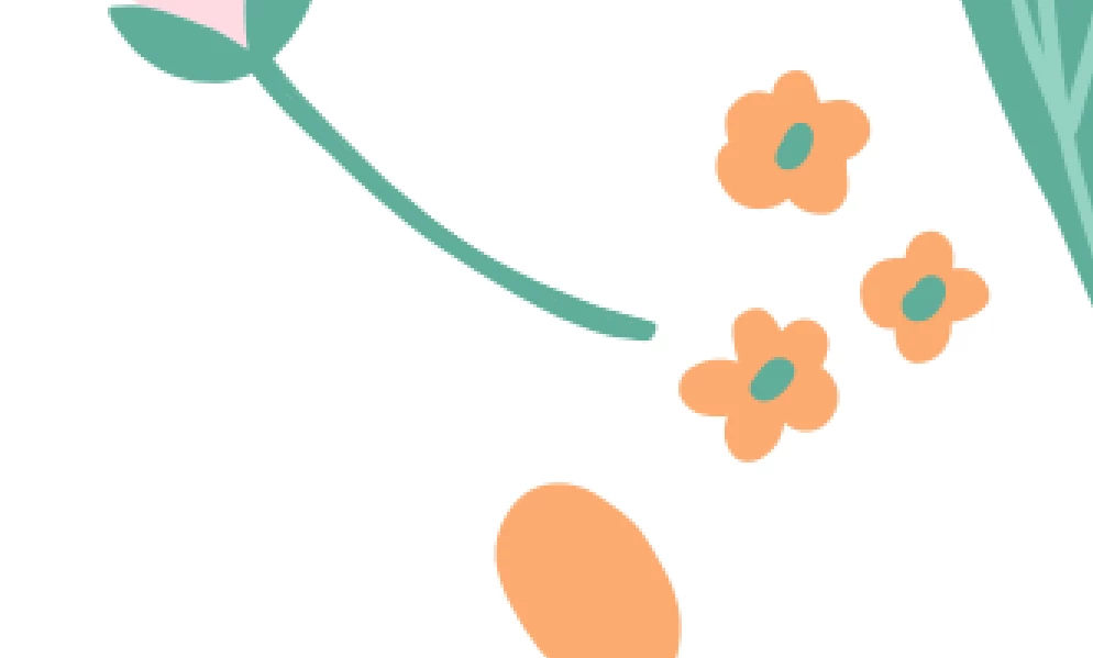

Vector brushes are not actually creating vectors? I put artwork into Illustrator & its blurry!
When I open a vector that I created in Fresco (with only vector brushes), in Illustrator CS6, I convert it to objects obviously because I want it to be a vector.  The images are blurry. They are not actual vectors. Do I need special brushes?  Is it because of CS6?
How can I create vectors to upload into illustrator? Can someone please help me?  Thank you!
