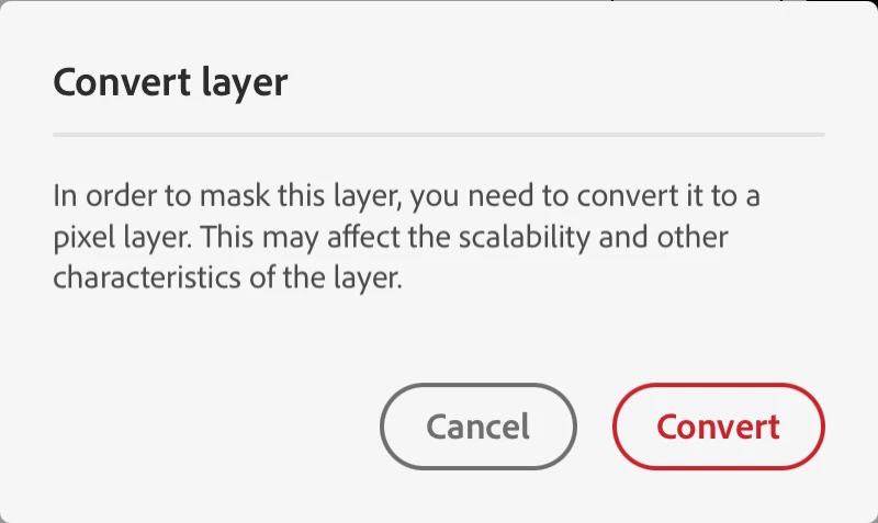

When you create a clipping mask in Fresco, you get a warning dialog box that says, "In order to mask this layer, you need to convert it to a pixel layer. This may affect the scalability and other characteristics of the layer."
So, I think the answer to your question is, clipping masks over vectors in Fresco are converted to pixels as soon as they are created. There is no vector to export once you've created the mask, it is now a pixel layer.
