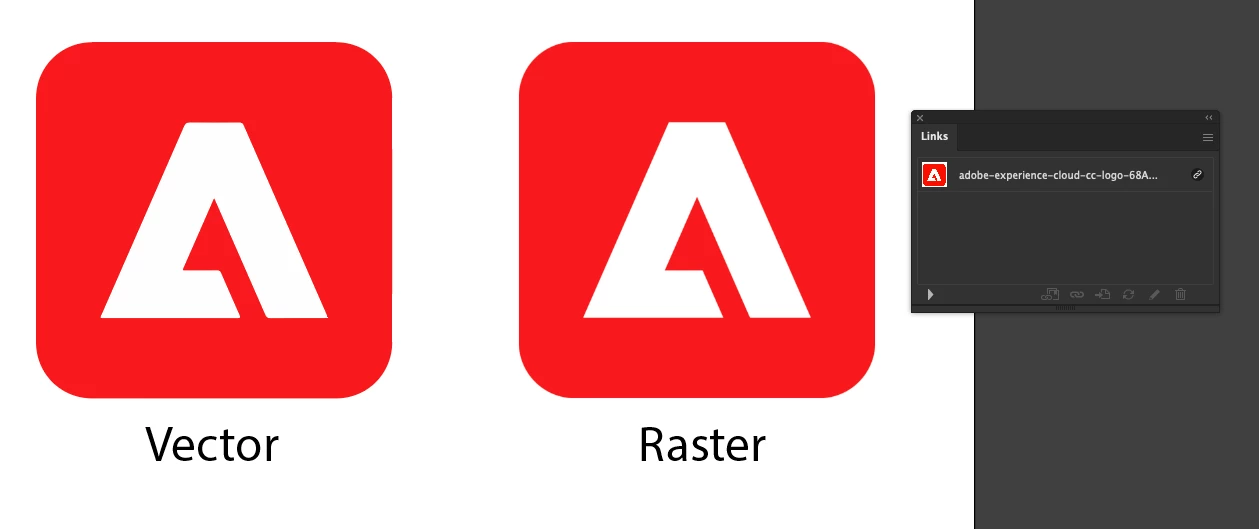

  2. Divide Appearance?  — I think you mean Expand! When you apply certain effects, brushes, or live text in Illustrator, they are "live" or "dynamic." This means they can be easily edited. "Expand Appearance" (or "Expand") takes these live effects/objects and converts them into editable paths and fills. It "bakes in" the appearance. If "Expand Appearance" is greyed out, it means the selected object doesn't have an "appearance" that can be expanded. This typically happens for very basic shapes (simple fills and strokes) that are already just paths and fills without any special effects applied. If you draw a basic rectangle and fill it with a solid color, there's no "appearance" to expand because it's already as "expanded" as it can be. Simple fills and strokes are vector. They are defined by paths. You can tell if an image is raster by zooming in heavily – if it pixels, it's raster. If the edges remain perfectly smooth, it's vector. Another hint is looking at the 'links' panel, if there is an image it may say what it is:
    And if you view in Outline View (Command Y on a MAC) (Control Y on a PC)
    You will see the nodes, paths, and anchors (vectors) and the image as an X (raster). Just click (Command Y on a MAC) (Control Y on a PC) to go back to Preview Mode again
