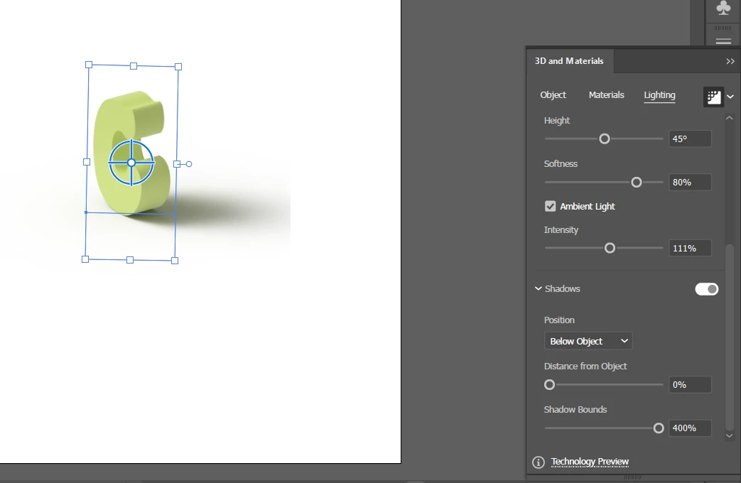

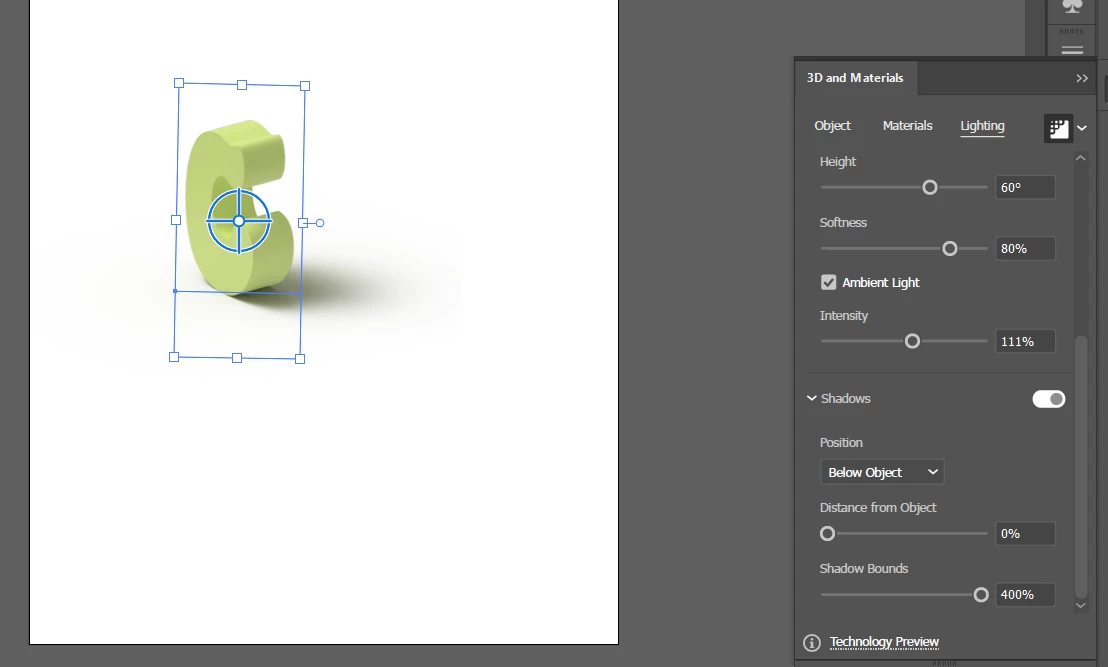

Hi Can you please help me, the shadow bound is at 400% (the max) and there is still the sharp edge.  (see picture below).. I have looked everywhere and don't know what to do ...
Hi @elianemarchand ,
So I tried to match your setting best as possible and unfortunately the only solution I could find was to increase the height %. Below are 2 screenshots, first with your original settings and the second with height increased. Sorry after much tinkering this is the only thing i could come up with (changing the text size doesn't do anything btw). If someone can find a different solution, that'll be great!
