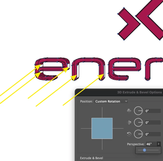

As soon as i use the perpective function in Extrude and Bevel the "3D representation" is not complete.
See picture for detailed explanation.
Happens every time. Any solution to this?
Correct answer Ton Frederiks
Sometimes a little rotation around one of the axis (try the Y for example) makes it render correct.

Ton FrederiksCommunity ExpertCorrect answer
July 7, 2021
TKAMDALAuthor
July 7, 2021
Thats totally right. All axis need to be at 0 degrees for this to be an issue.
I presume its an issue for all users then. Not only me.
Its a quallified workaround thou.
Ton Frederiks
July 7, 2021
It is not only you.
And sometimes rotating it back to 0 corrects it too.
