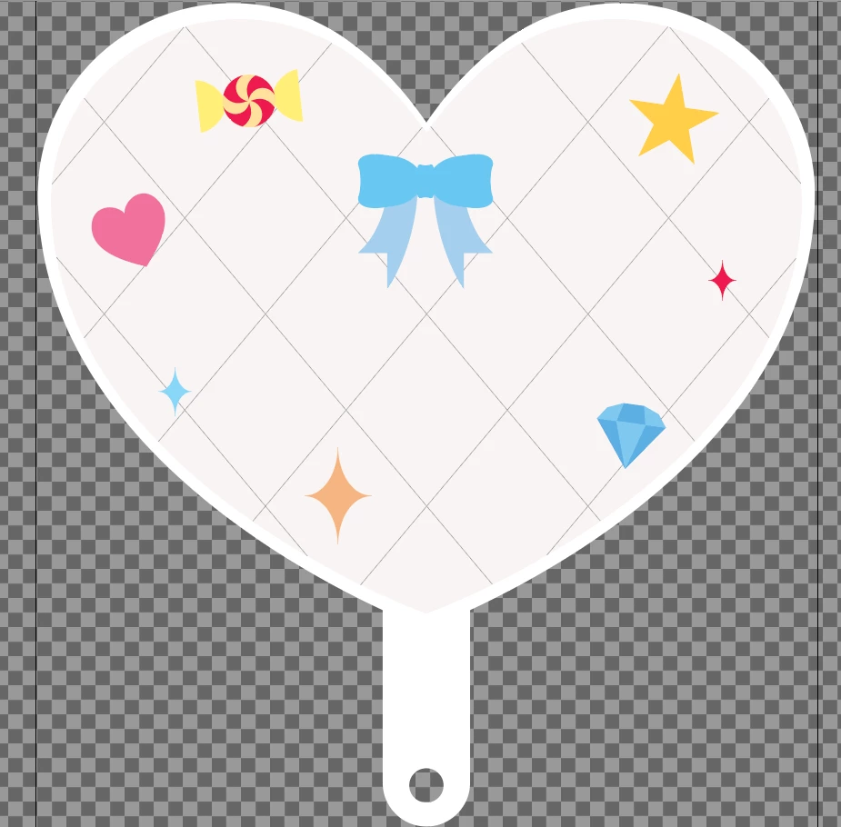

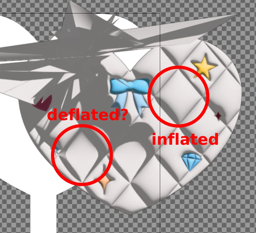

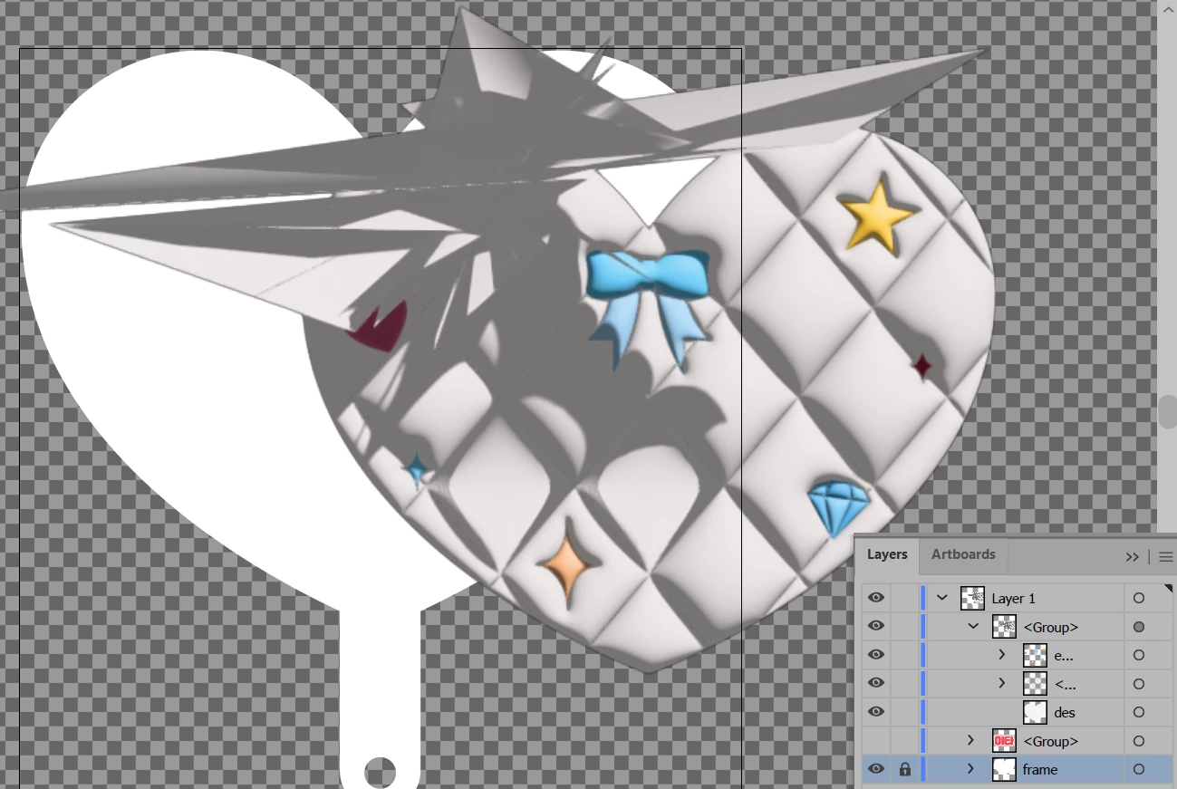

I was trying to render this design in 3d inflate but then it came out with weird shapes like this. I don't have any layer that would create this though. I also have a problem where the render is supposed to look inflated but certain parts somehow looks deflated? Does anyone know what's the problem here?

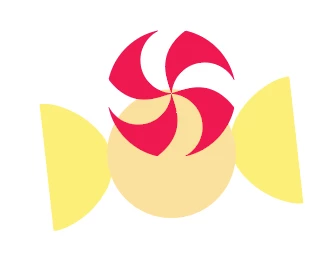

There are tiny holes in your "sweet" artwork. Build it like this and then it will work:

Can you share the AI file?
Change the extension to .PDF, then you can upload it in this forum.
Sep 27, 2024 10:10 PM UTC
Hi! Here is the file. Can you help me check?
