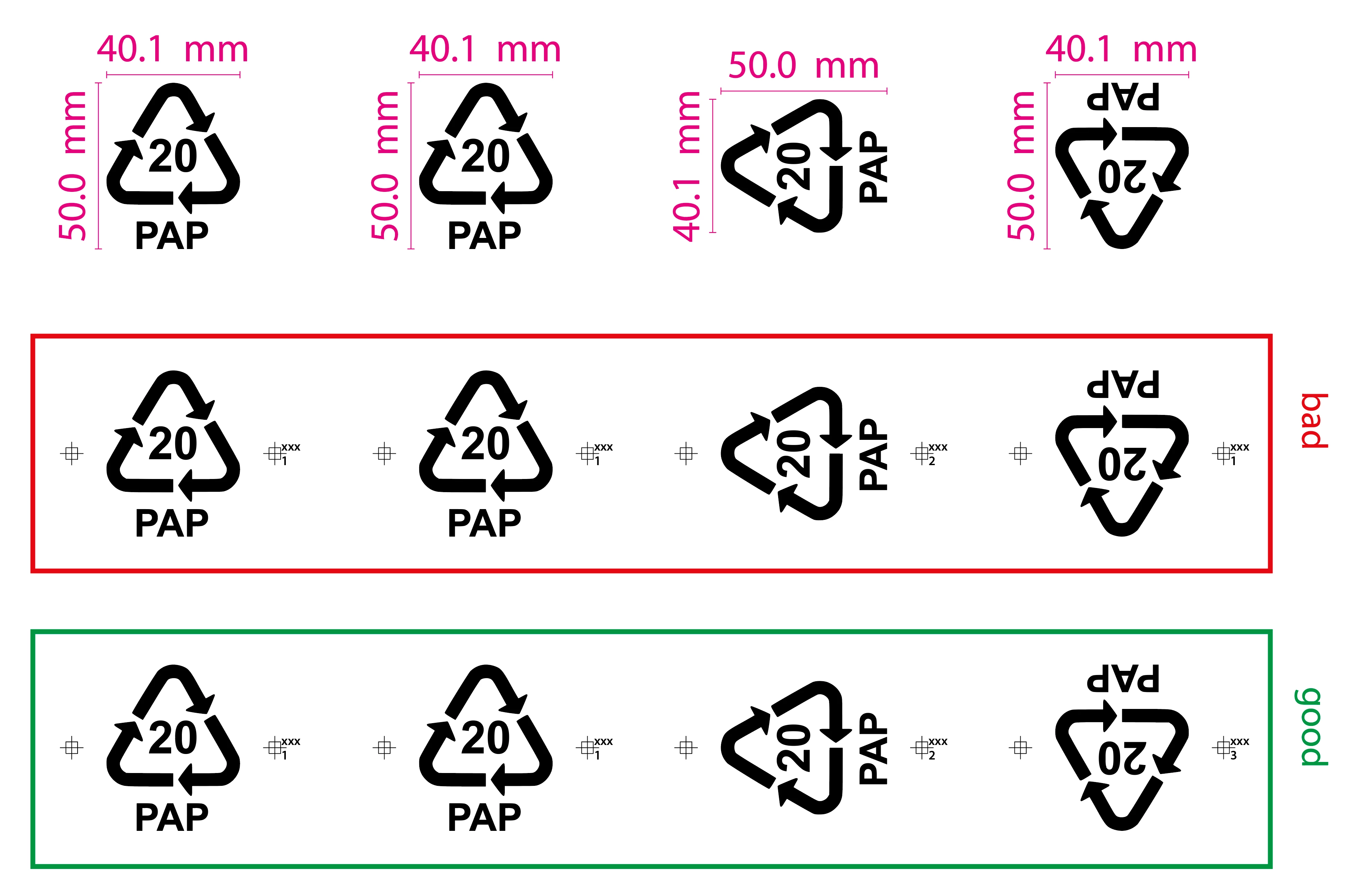

I have a question as in the subject, is it possible to create a script that will be able to distinguish two objects, or groups of objects, if one is turned 180 degrees relative to the other?
In the case of objects different from each other there is no problem, it checks its dimension and when they are different the script knows that they are different objects, but I have a problem in the case when the objects are the same size, but are turned 180 degrees, their size is the same.

I once created a script to insert registration marks into objects. In registration marks each object is numbered. this script is able to distinguish whether an element is the same or not based on its size. When an element is the same but is turned 90 degrees, its size is different (X swapped with Y), so the script knows that these are different elements. I want it to be the same when the object is turned 180 degrees (the script must distinguish these elements not by their size because after turning 180 the size is the same)
