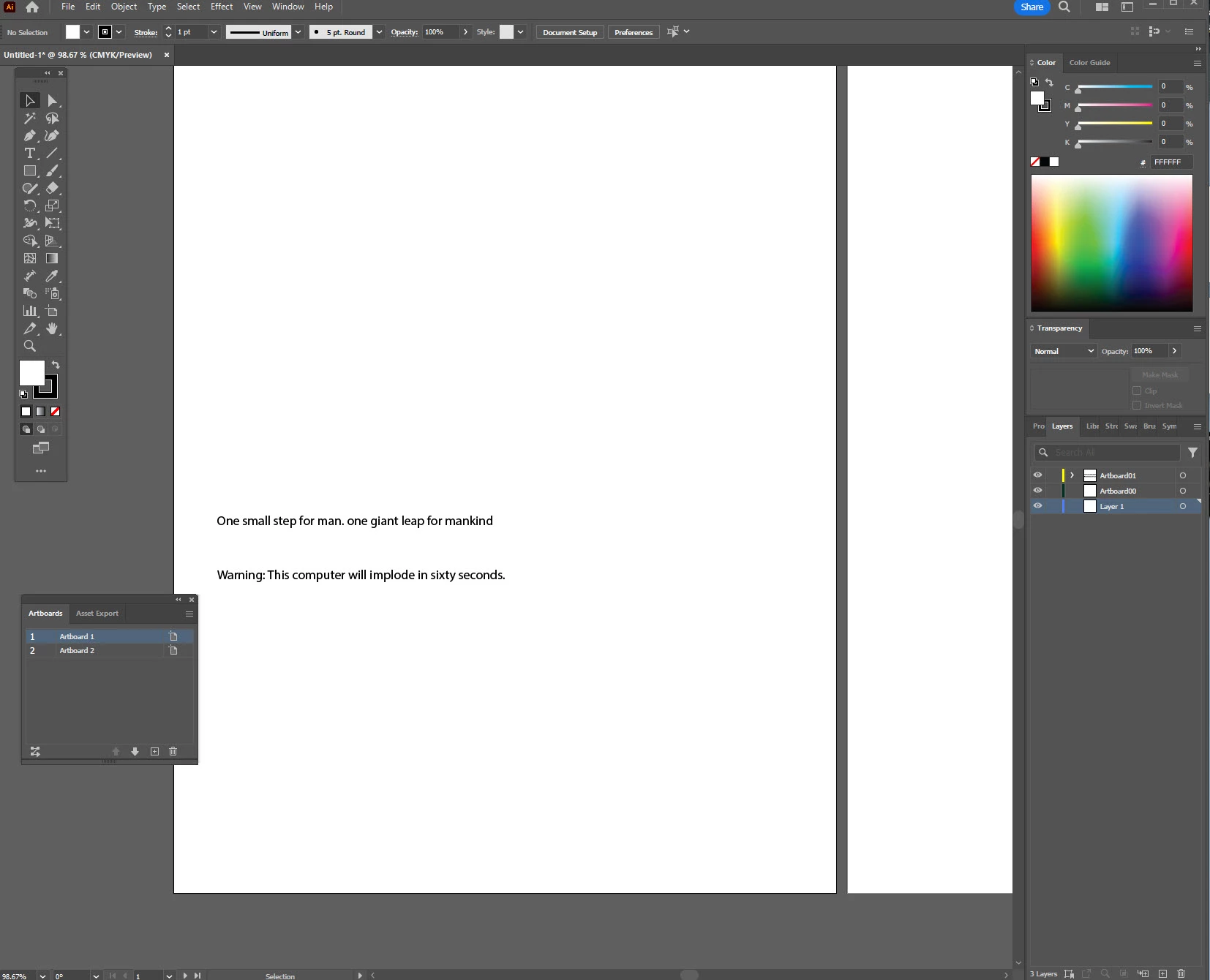

I believe the key to addressing multiple pages and layers is through activation. I mention this as I might be way off base with this idea. I want to activate an artboard and associated layer. Fill the page with part of the sequence, save the document, then switch to the next artboard and layer and continue with the sequence.
So far, I have utterly failed to get this to work. A simple test application is shown. Two artboards and two layers are generated. The first artboard and second layer is activated and a text frame is made to hold a sentence. Next an attempt to activate the second artboard and third layer is made and a new text frame with a sentence is written to the newly activated layer and sequence.
What happens is that both sentences appear on artboard 1 and in layer 2. Screen shot made; not sure if allowed but will try.
Kindly have a look and let this idiot know what I am doing wrong.
Many many thanks for taking the time to look at this problem and taking the time to correct my thinking or code or idea.
