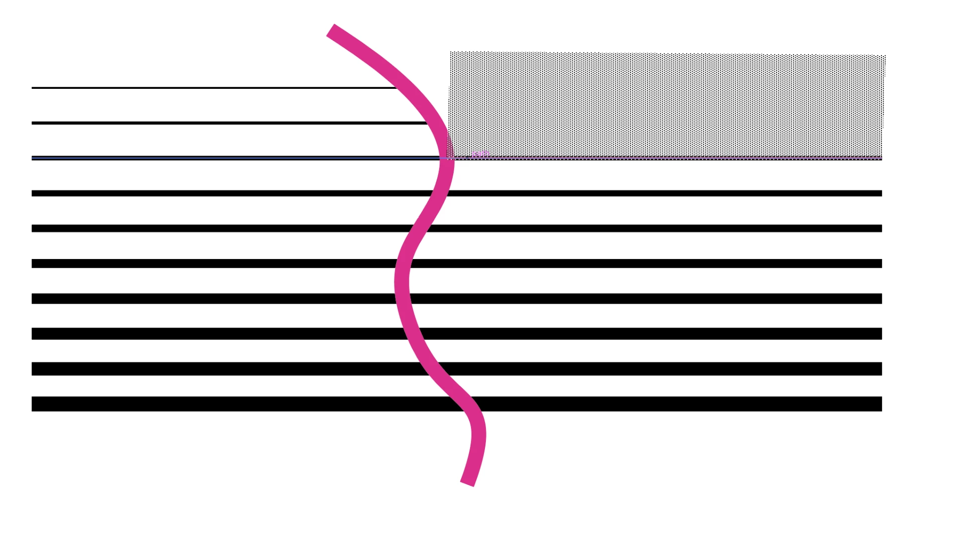

I'm trying to use a (complex-ish) shape to add anchor points to another group of paths where the paths cross over- however i'd like to do it without effecting the stroke weights etc as then the blend will lose its gradient effect.
For example, i'd like to add points to the black strokes where the pink stroke crosses over them without the black strokes losing their relative weights. Diagram
I've tried Pathfinder and different ways of stacking the two items but it either isn't doable or it instantly removes the stroke.
Any suggestions?

Sorry should have been clearer.
Basically it's to trim the lines at that point, I could use a clipping mask but then that just adds extra complications down the line, I could outline the strokes then trim them in pathfinder but then they're no longer strokes, so lose some edit-ability, it's a bit of a catch 22 however I think about it.

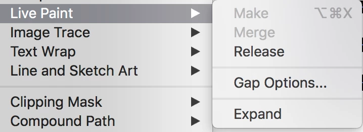

Hi John,
Don't be sorry, we are clear now!
I just tested Live Paint. Is this what you want? If so, select everything, then convert to a Live Paint Group with the Object menu or the tool (K).
Use the Live Paint Selection tool (Shift+L) to delete what you don't want, then Expand from the Object > Live Paint menu.
Make a copy first to test, of course.
Jane

Hi John,
I can’t think of anyway you can add anchor points to the black stokes automatically where the pink stroke crosses. The only way I can think of is manually using the Add Anchor point tool with Smart Guides on. You might have to lock the pink or use isolation mode on the black or change the stacking order to make sure you are adding anchor points to the black, not the pink.
But you say it’s a Blend, and it won’t work with a blend, because you only have the first and last lines. Look in Outline view to confirm. You would need to expand the Blend to make them into paths before you can add anchor points to them.
~ Jane
March 3, 2019
Hi Jane, the blend is expanded so it's just a series of strokes, however I want to keep the relative weight that the blend created on the in-between lines only reason I mentioned it was a blend really. I could do it manually as the anchors will snap to point but i'm after a quick fix as it's a big job that requires me to do this alot.
Thanks!
