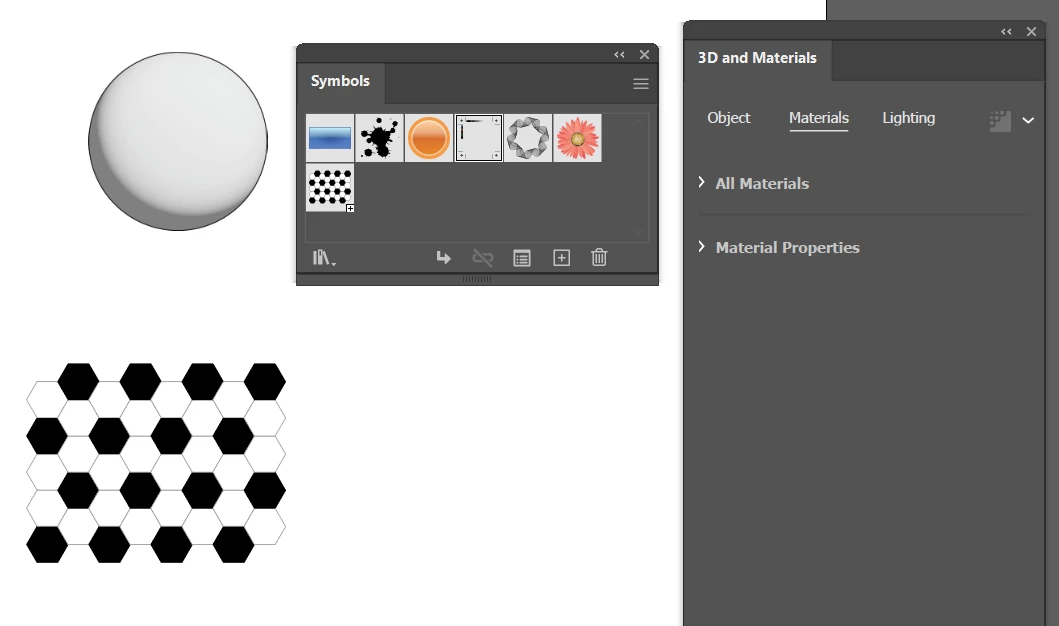

How do i add my newly symbol design to 3D and Materials under graphics using adobe illustrator, when i click on material tab i only find All Material and Material properties i do not see Materia Graphics, where my symbols designs can be added to graphics, i also did not see ad graphics.

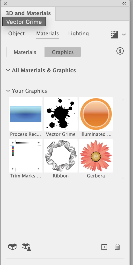

You should have a Graphics sub tab under Materials, but I can't verify that was available in AI '22 as it is in '24 (below) and '25.
The problem could also be document-specific.

  8. If the Graphics sub tab appears, click it; you should see your symbols. If it doesn't, click the plus button at the bottom of the materials list and choose Add as Single Graphic, which should then show your symbols.
If that process doesn't work, you might need to get Illustrator updated, as @Monika Gause suggested.

Adobe Illustrator 2022, i followed several steps on youtube, i created my footbal design then added the design to symbol, created my circle then inflate, needed to add my design through graphics under 3D and Material but i didnt find graphics beside material under 3D and Material, others have symbol designs added to graphics under 3D and Material beside Material

1. Which version is it?
2. That is not a football and will not work.
