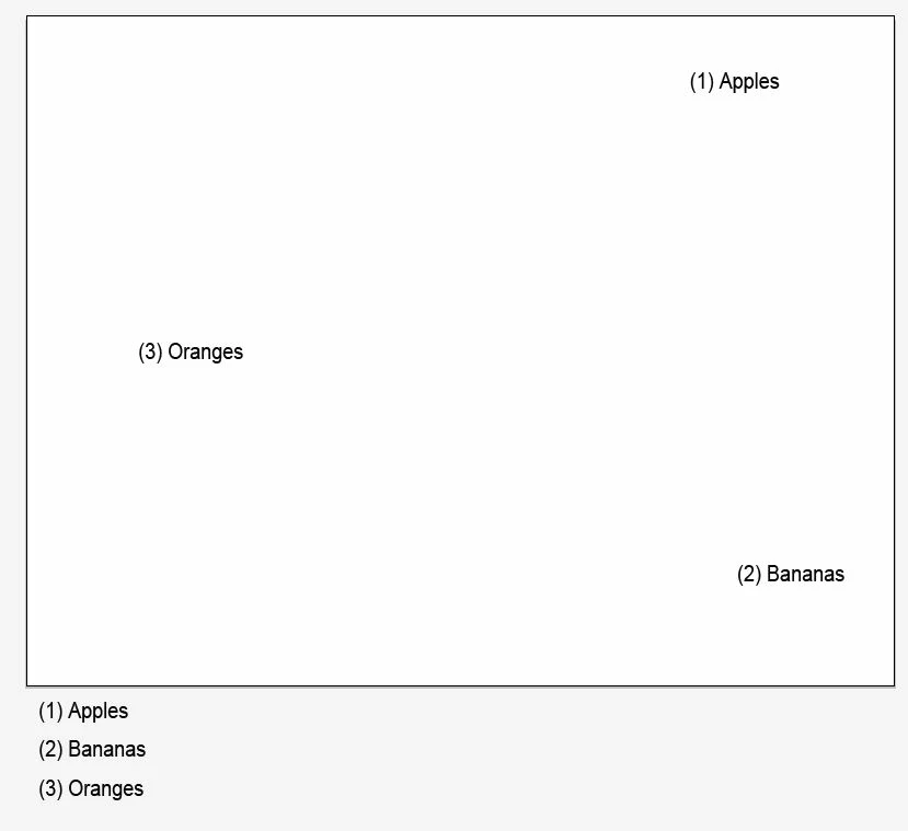

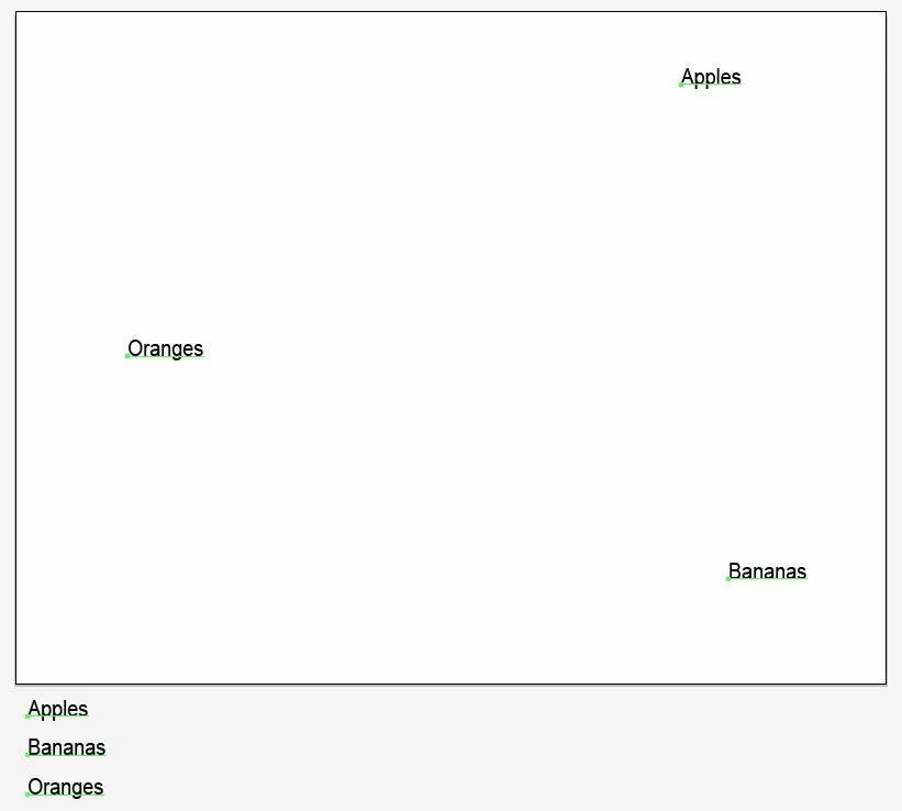

So the goal is to have a numbered list to reference items that are spaced out on a large artboard.
They are all individual textFrame items. My issue is I don't know how to get the formatting I want of (#) inserted back into the textFrame when it finds an array item. The list will ALWAYS match. The reason for splitting and sorting them is to find out how many items there are so that a number can be assigned. Here are 2 screen shots of a file before the script would be run and my goal for after the script
Hope this helps clarify some. Thank you for your reply!
