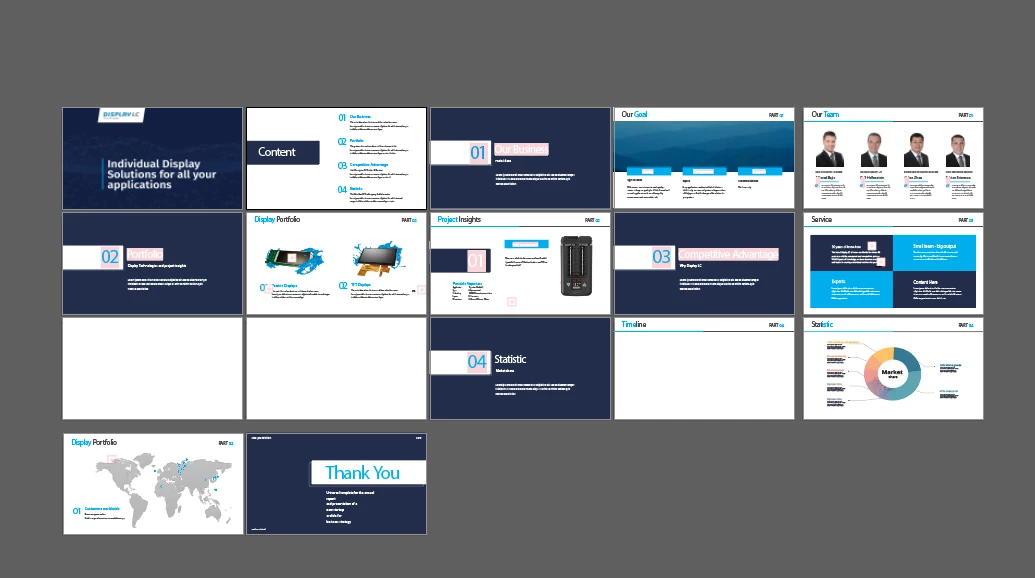

Dear All,
Im quite new to AI but found a nice presentation template on Adobe stock.
Now I don't know how to make new slides with AI, since the number of slides from the template doesn't make sense for me. Can somebody help? Thanks in advance!

I guess as 'slide' could equate to an artboard, depending on how the document is set up. But templates from stock are a crapshoot. You should probably show screenshots of what you have.

Thanks for your reply! I tried to add new layers (same as the picture on the right) but that doesn't help either...

If you want to organise new slides the same way the template creator did, you would create a new layer, create a new artboard, name them the same, then use that layer when working on the corresponding artboard.
If you're expecting some kind of template-like consistency between the built-in slides and new ones you create, Illustrator isn't really set up for that (having no 'master' page equivalent).
