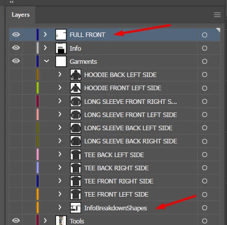

Hi community, I got a question, I've been struggling with this issue for around three hours already.
I have an user interface, which I don't use it to copy/paste just to gather information, and when I click in "ok" to do it's thing, AI suddently does not paste what I commanded it to copy, using app.executeMenuCommand("paste"); does not work and app.paste(); shows an error message with the code 171 saying that is an internal AI error, funny thing is that when I close/open AI it works again (note that when I re-open AI i did not run the user interface)
also, in the same moment I run the UI, and copy another thing by control + C it does not paste either, not until I restart AI.
does anybody know what could be happening? please and thanks
Correct answer AntonioPacheco
Hi! In the end, what I did is to make the script wait like a second before execute the command for copy or cut, because I don't knwo why, the script/illustrator runs the code so fast that it just ignores or pass the code line, so I did something like an alert in between or:
alert("wait a second");
$.sleep( 999 ); /*Milliseconds*/
alert ("done");
and it worked good, hope this helps!

Hi Community,
I have no explanation for what's happening about the copy/paste thing here but since I can't be stuck in the same error for a day, what I did is to bring the content I need from that layer directly from abother document, so I did:
app.open(File("C:\\AuxFile.ai"));
app.executeMenuCommand("selectall");
app.executeMenuCommand("copy");
app.activeDocument.close(SaveOptions . DONOTSAVECHANGES);
app.executeMenuCommand("pasteInPlace");
app.executeMenuCommand("sendToBack");
app.executeMenuCommand("deselectall");
Hopefully I can have the solution for this someday, in the meantime, copy/paste the object from another document works.

Sorry!  I was trying to figure out what's happening but no results, here is the code:

the exact part not working is:
var doc = app.activeDocument;
var myLayers = doc.layers;
// alert(myLayers["Garments"].layers["InfoBreakdownShapes"].name);
myLayers["Garments"].layers["InfoBreakdownShapes"].visible = true;
myLayers["Garments"].layers["InfoBreakdownShapes"].hasSelectedArtwork = true;
myLayers["Garments"].layers["InfoBreakdownShapes"].visible = false;
doc.activeLayer = myLayers[0];
app.executeMenuCommand("pasteFront");
What I am trying to do is, select all the objects in this layer InfoBreakdownShapes (whether is visible or not) to the new layer the code generates at the top , image attached:
I am attaching the file I am using, as per the community rule it has no private information.
In my opinion... the code gets adobe stuck or something like that and I must figure out how to:
unhide layer
select all in that layer infobreakdownshapes
copy
paste in the new generated layer
send it to back so the information is visible
hide again the layer (this hide/unhide is because that layer called breakdownshapes is needed just to duplicate its contents everytime the code is run, but I am thinking now in just create the shapes via code.)

I just discovered that when I move that specific part of the code which selects all in a layer (hasSelectedArtwork) and paste that code in a new VS code doc, works good. It's like something is messing up while executing the UI.
February 15, 2023
I just provided the code, one more thing... if you run the code block where I have the error, it will run perfectly (without being in a UI)
